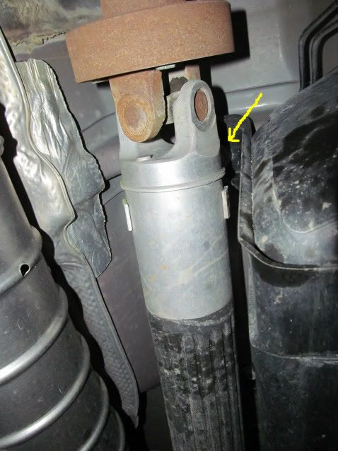

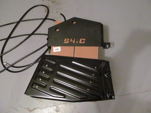

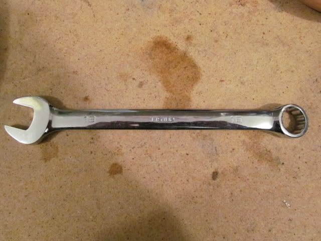

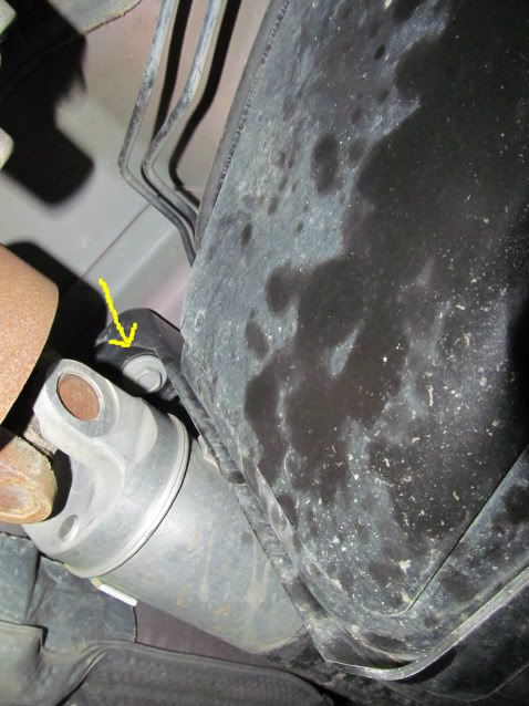

Had some time to do some work under the WK and figured I'd update the build so here's the latest additions:
Some things that are a must and one that just makes this install a little easier IMO: The S4xC adapter doesn't come with any hardware as it uses 2 factory bolts on the forward most fuel tank strap. An 18mm wrench is needed for the inboard factory bolt and a deepwell 15mm socket is needed for the two nuts that bolt the Mopar t-case skid to the adapter plate. A regular 15mm socket will get these started but you won't be able to seat the nut without a deepwell. Also, I jacked the rear up higher on the passenger side so as to push the drive shaft away from the fuel tank. It is minimal and may not have helped much but getting the adapter plate inboard "arm" between the fuel tank and the driveline is tight - I figured any little bit would help. The install instructions say to slide the adapter in from the rear of the fuel tank and slide it up as there is more clearance this way - I didn't notice it made a difference.
The factory bolts that are used to mount the adapter plate:
(Notice how tight it is to get to the bolt above the driveline)
Same bolt from pretty much directly underneath:

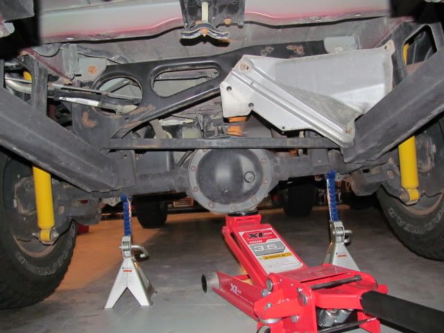

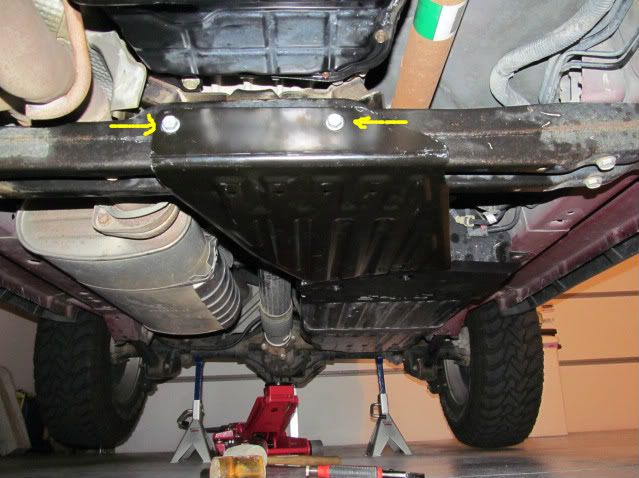

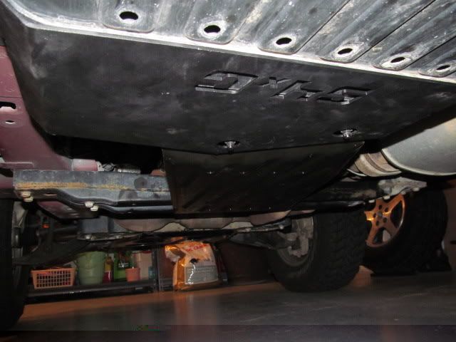

Once you get the adapter plate in place go ahead and torque the mounting bolts all the way. The instructions mention if you're mounting the t-case skid to leave them loose in order to fit the two together. I found that getting to the inboard bolt for the adapter with the t-case skid in place made it very difficult to get to the bolt. So, again, torque the adapter plate before you mount the t-case skid.
Once you get the t-case skid in place go ahead and pop the front bolts in to hold it but don't tighten them down yet.

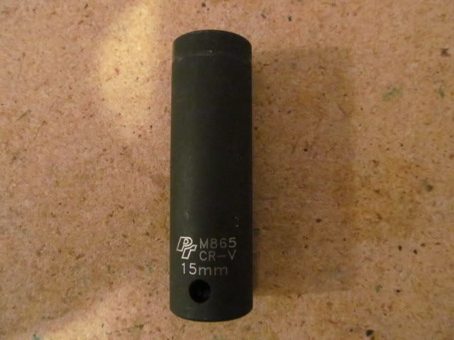

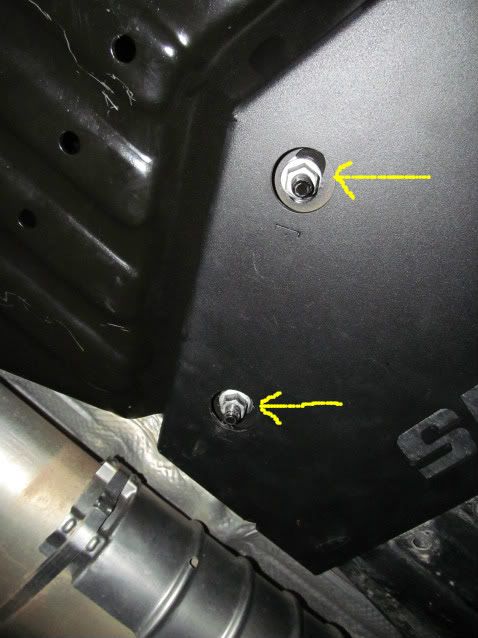

These are the two 15mm nuts that you want to have a deepwell socket for. Like I said earlier, a regular 15mm will get you started but the bolt stem will bottom out inside a regular socket and it will feel as though the nut is fully seated - not so. I found out the hard way and almost stripped out the nut at the bottom of the pic as I was waiting for the torque wrench to "click."

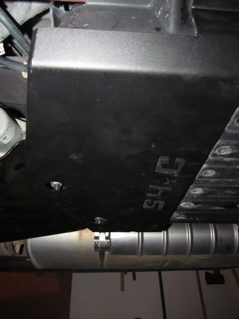

Also, the two pieces don't "lock" together as there is quite a tolerance in the fit, which is why it works best not to torque the front t-case bolts until you get the rear nuts torqued all the way.

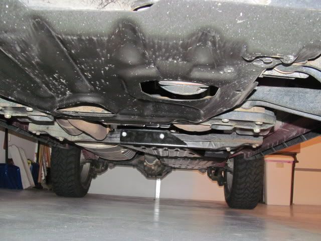

Once the rear nuts are torqued go back and torque the front mounting bolts for the t-case skid and everything is set.

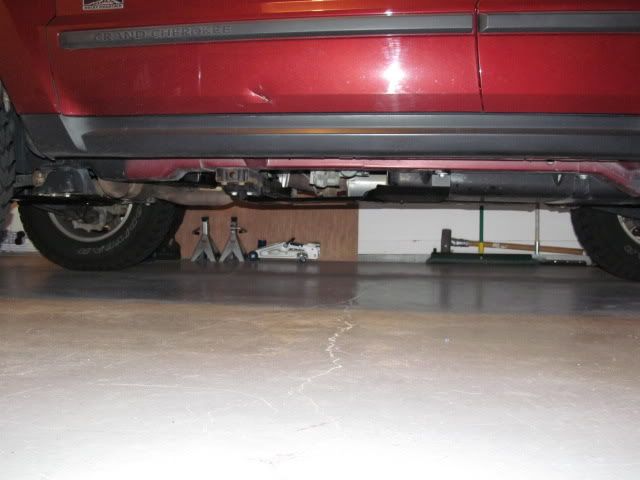

Everything tucks right up underneath the rig with little to no loss of ground clearance.
