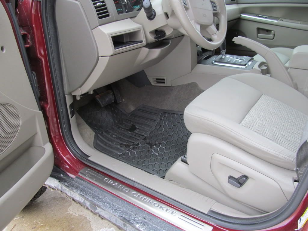

Mopar front suspension skid and Mopar t-case skid. We got our first snow of the season last night and today - nothing major - but enough to make the WK a mess and it is sitting in the garage "melting" right now. Install on the front suspension skid will have to wait for better conditions. The t-case will have to wait untill I save for the S4X adapter or I might be able to get my best bud's dad to fab something.
Also, they aren't Husyliners or Weathertechs, but I picked up some all-weather floor mats from Costco of all places. They aren't an "exact" fit but for $10 for all four it was worth throwin 'em in for the winter - just in time too!

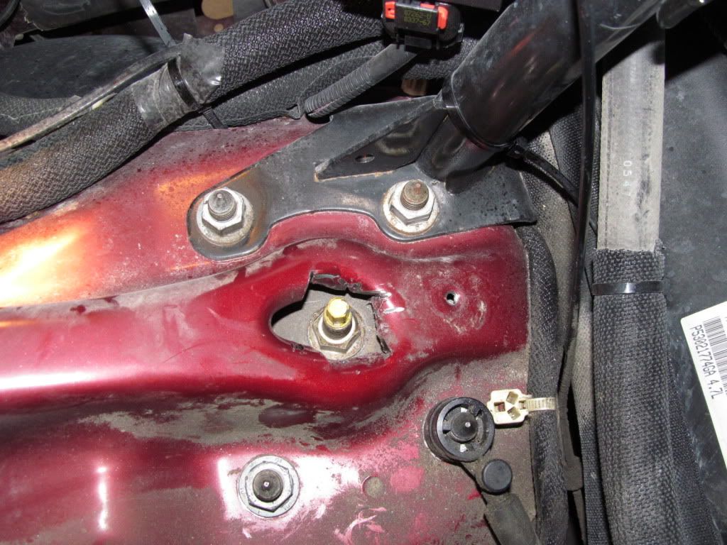

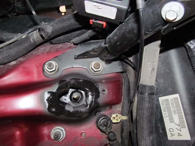

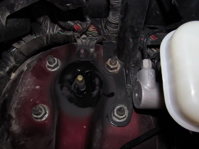

Well it's been some time since the OME install and I had some time on my hands today to tinker, so I thought I would go through everything and retighten all the dis/connection points. Plus, I know alot of WK guys are wondering about the center nut on the strut tower and "clunks". I've noticed some moderate noise coming from particularly the front driver side and I decided to "tear" into this thing.
First things first the airbox and radiator fluid reservoir had to get moved out of the way. I also covered the resonator box inlet and the intake box because I used a dremel, cutting blade, hammer, and flathead screwdriver to "bore" out the opening to the center nut and I didn't want anything getting in my intake system that wasn't supposed to.
On the driver side there are three 10mm nuts to be removed and the entire electrical "center" can be moved enough to gain the access needed. It also helps to disconnect the main electrical bus and anything else that limits the travel of the "center". This is all the same stuff needed to gain access to the strut mounting nuts when a lift install requires dropping the whole strut cartridge.
I used the dremel to make "relief" cuts around the opening and a hammer and flathead screwdriver to basically create a rough opening large enough to get a deepwell impact socket on the center strut nut. It's not pretty and involves some pounding but that's why I called it a "rough" opening. This is all a cheater method to actually dropping the entire strut cartridge.

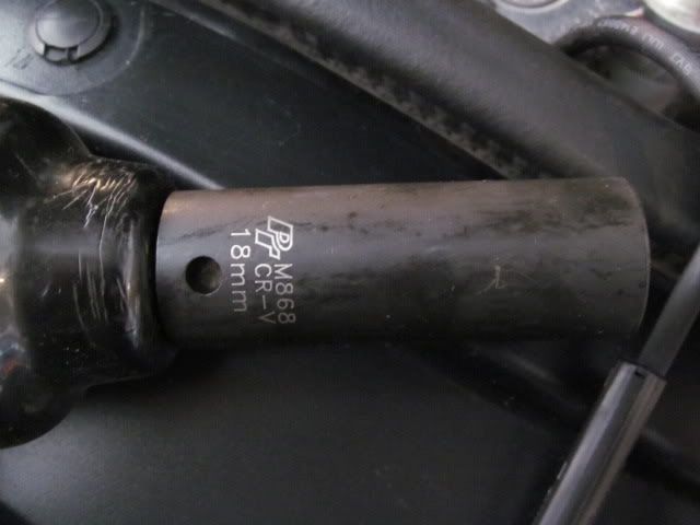

The mounting nuts and center strut nut all take an 18mm socket and you'll have to use a deepwell for the center nut - so you may as well use it on all of them. Airtools are very handy:
After torqueing the mounting nuts and strut tower nut down with the impact gun I sprayed the openings with a few coats of Rustoleum. The paint was still drying when I snapped these pics:
I would also recommend disconnecting the battery before starting this because you will be disconnecting and/or relocating some of the electrical stuff under the hood so I think it's better safe than sorry.
I discovered that all my mounting nuts and the center strut nut all turned slightly when I torqued them down. My sway bar brackets at the bushings tightened down a little, too. My sway links, ball joint nut at the top of the spindle and the bolts that connect the lower fork to the bottom of the strut were all solid, as well as the rear sway links. The biggest impact sockets I have are 22mm and the clevis nut is larger than that so I couldn't check that. I was on a time constraint as my girls' bus was about to drop them off from school so as far as a test drive and post tinkering report everything seems solid after a quick spin around the block.
Hope this helps somebody out there.
