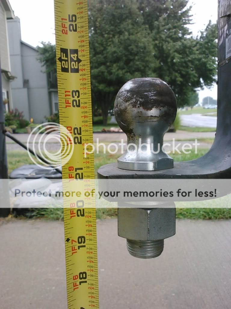

Do you want to know my ground to factory hitch measurement or ground to top of ball for the 6" and/or 10" drops?
I was after the height from ground to top of tow tongue (that tow ball mounts on) for both the 6" & the 10" drop.
Cheers, Craig

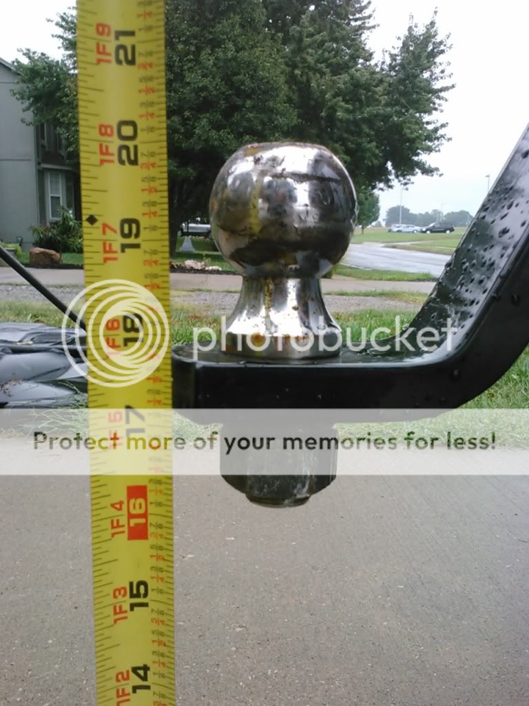

Cheers, Craig
Gotcha.
My factory receiver measures a hair under 27" ground to top of receiver tube.
My 6" drop measures just under or right at 21 inches ground to tongue.
My 10" drop measures right around 17.75" ground to tongue.
Hope that helps!

Thanks Mike. Mine works out to be 16.5 inches. Works well for my 2 trailers & boat.

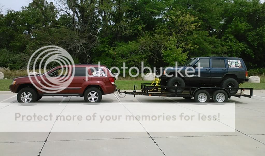

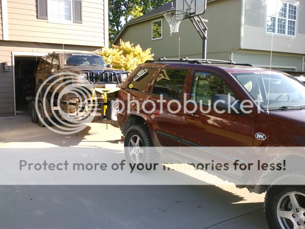

So the brown truck delivered my 8" drop ball mount yesterday. Curt 10K lb GTW and 1K lb tongue - takes a 1.25" shank ball. Got it off Amazon for 37 bucks with free 2 day shipping. I had a 2" ball w/ 1.25" shank on the 6" drop so I swapped them out last night.
Today I set everything up with spares, step blocks, tools, recovery gear, yadayada.........pretty much everything I would tow/haul minus any other passengers and cooler etc.
This is the set-up with the 8" drop:
Sags the back by almost 2" but it pulls solid, smooth, and straight - feels very stable. Preliminary fuel econ is unsubstantiated just yet,
but the tow tune on the Superchip and tow/haul engaged will give me my best results. Don't know that I'll bother with a WDH but I'll have to see after towing a couple trips with it.
Right now I'm gonna say it's good to go.

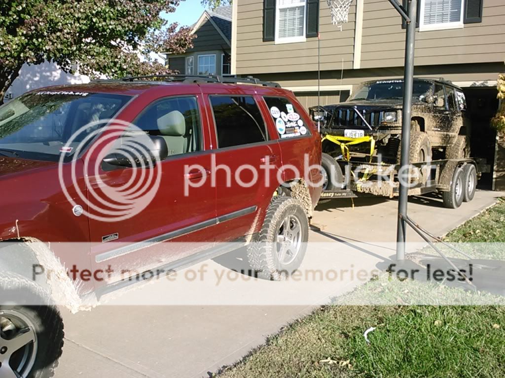

It does great actually. Much better than I would have thought. Pulling wise it feels no different than when I would dolly the XJ. However, it is much smoother and more controlled - much. With the OME heavy duty springs my rear end sag is 2 inches by the tape measure with a load of approx 5800 lbs and a tongue weight of around 650lbs.
I have the tow group IV package and engage the tow/haul function, as well as run the tow tune on my Superchip and it gives me 12 to 12.5 mpg. Getting up to highway speeds from an on ramp will put me up into 3500-4000 rpms but once I level out at 65-70 mph it drops down to 1800-2000 rpms, cruise control set - and just go.
Aftermath from yesterday's trip - (I have the jack set on the trailer so it looks like I have zero sag):
