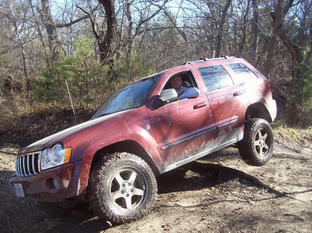

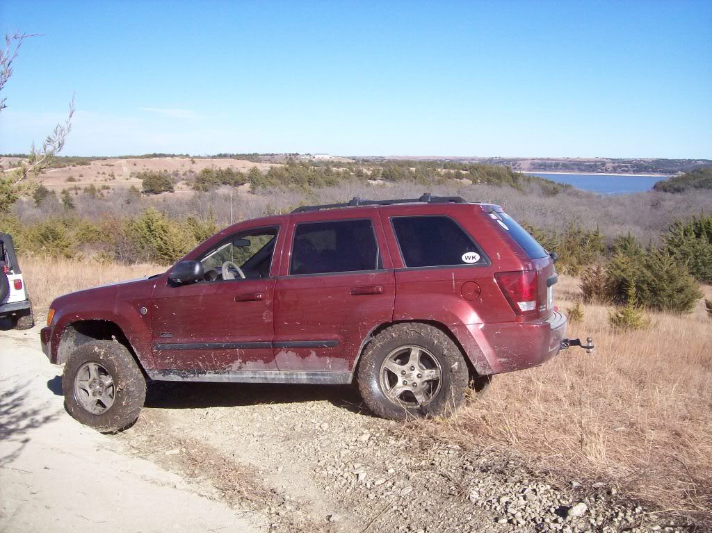

Nice pics... I see you gave that you stretched the legs on the jeep - Very nice.
Oh yeah ... I was stoked to experience what a WK armed with an OME, off-road tires, and QTII can do. It didn't let me down.

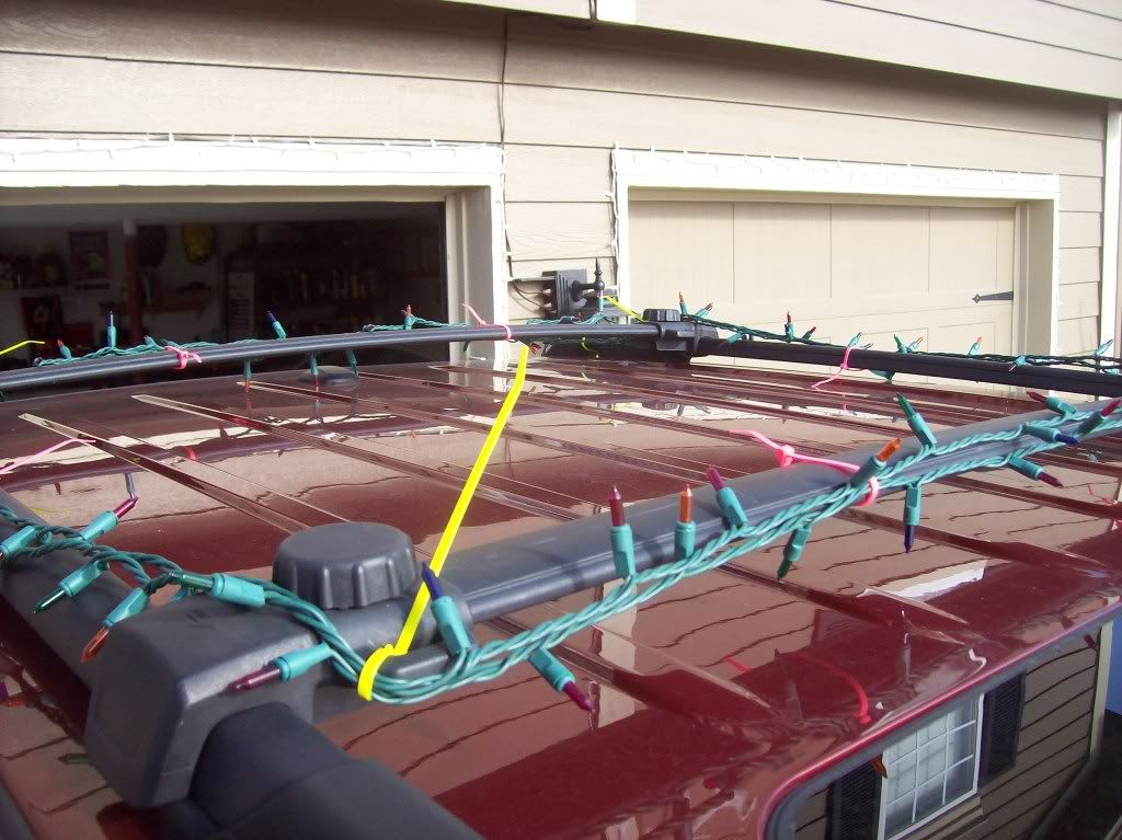

A couple of the latest mods I've done. Nothing major. Cheap, easy, and fun.
For Christmas I took an extra multicolor strand of lights and put 'em on the roof rack. I used zip-ties at each corner and the the middle of all sides to secure it. Then just ran the plug down the top of the lift gate to the rear interior. Used an inverter in the rear cig. outlet and plugged the lights into the inverter. I also finished sprucing up the underside of the rear end (axle, lower shock mounts, spare well rails). I sanded the rust out best I could with some heavy grit sand paper and used some flat black rustoleum in a rattle can. Figured a few coats would help protect with the snow season approaching (actually we had our first dusting the other day). Not to mention the salt that the road crews lay down I hate that stuff - nothing worse on the underside of a vehicle. My before pic is from a wheeling venture about a month ago at Tuttle Creek ORV just north of Manhattan, KS and the after pic may not reflect my work the best - but hopefully you get the idea.

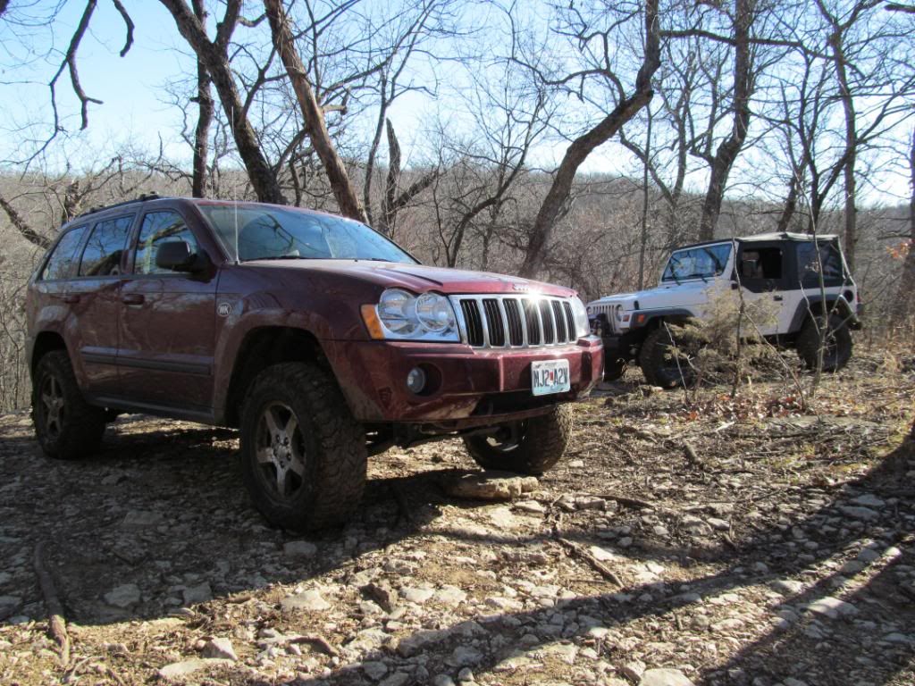

This was already posted in WK/XK pics thread but I like to think of my build thread as a photo journal of sorts. I can show what I've done to the WK and show what it enables me to do with it. Plus, again, it's MY build thread so I figure even if I'm not "building" something in every entry I'm showcasing the rig.
Some pics from the last day of 2011
KS Rocks Offroad Park:
This washed out crossing really kicked my @$$:
The winch of shame
The spacing of that rock and log on the right side (right at my front & rear tires), combined with mud, and only airing down to 20psi is what gave me trouble I think:
Check out the articulation of my Uncle's TJ:
You can't tell by the pic but he was lookin at quite a steep grade on that rock and his rig wanted to roll to the driver's side as his rear left was bottomed out while his front right was bumping up that gap. We set-up quite the rigging with his winch, two anchors with change of directions, 2 snatch blocks, back to his right front tow hook. It may have been overkill but it allowed a straight pull with the winch and and a "downward" pull on his right side which is what was needed here.
Planning our line up this rocky climb.
That climb resulted in some trail damage and I didn't even summit in the end.
If I'd stuck with my plan to stay the course of the main trails
this wouldn't have happened:
I used the 87 octane tune on the SC for wheelin. I noticed more power in my low gears in 4lo and after wheeling I used the SC to idle up while using my compressor to air back up. The SC mileageXS tuning gave me almost 19mpgs on the trip down there into a head wind and the drive back I ended up with 21mpgs! The WK has never seen that kind of mileage.
Overall, it was a great way to start the last day of the year.
