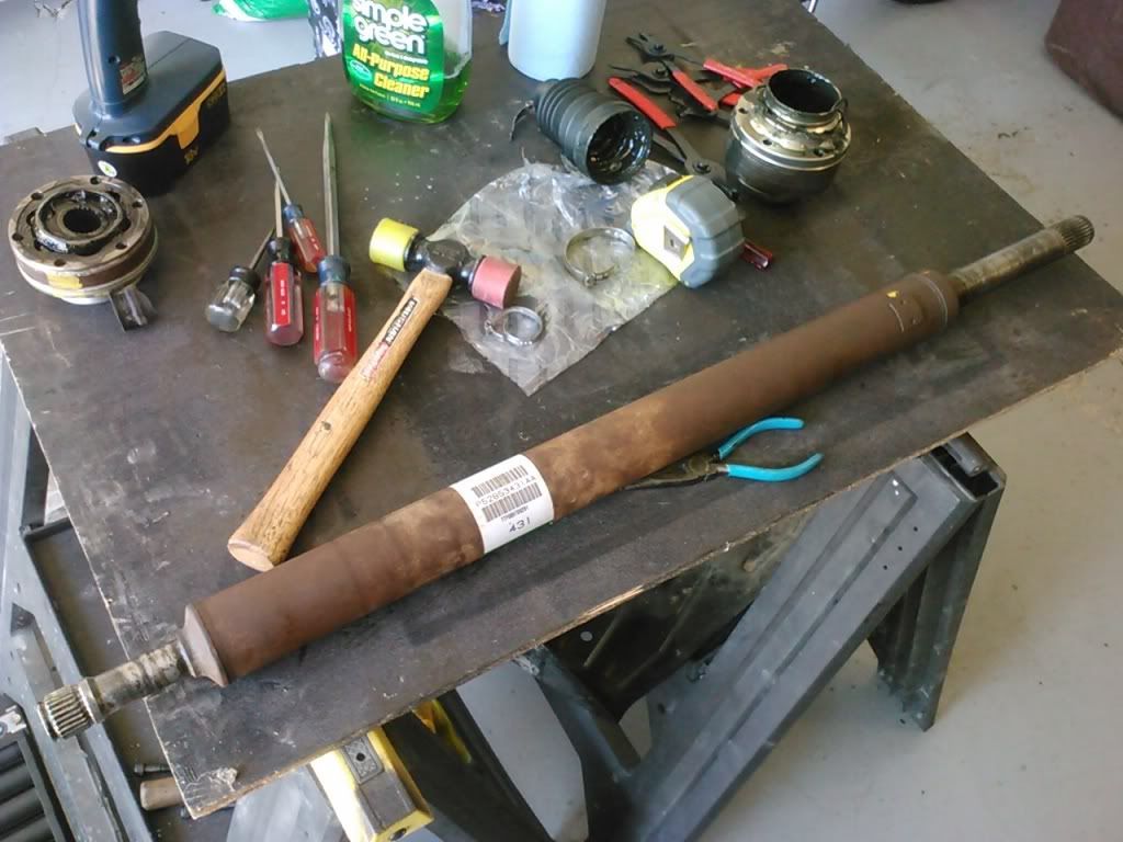

Got to the first project this morning - swapping the new the front drive shaft cv's.
Today proved one of my theories.
1. Life is short
2. Life usually doesn't go as planned
3. The way life does go is often disagreeable.
A shameless plug of the dog:

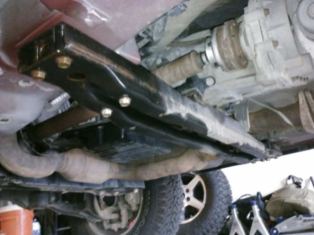

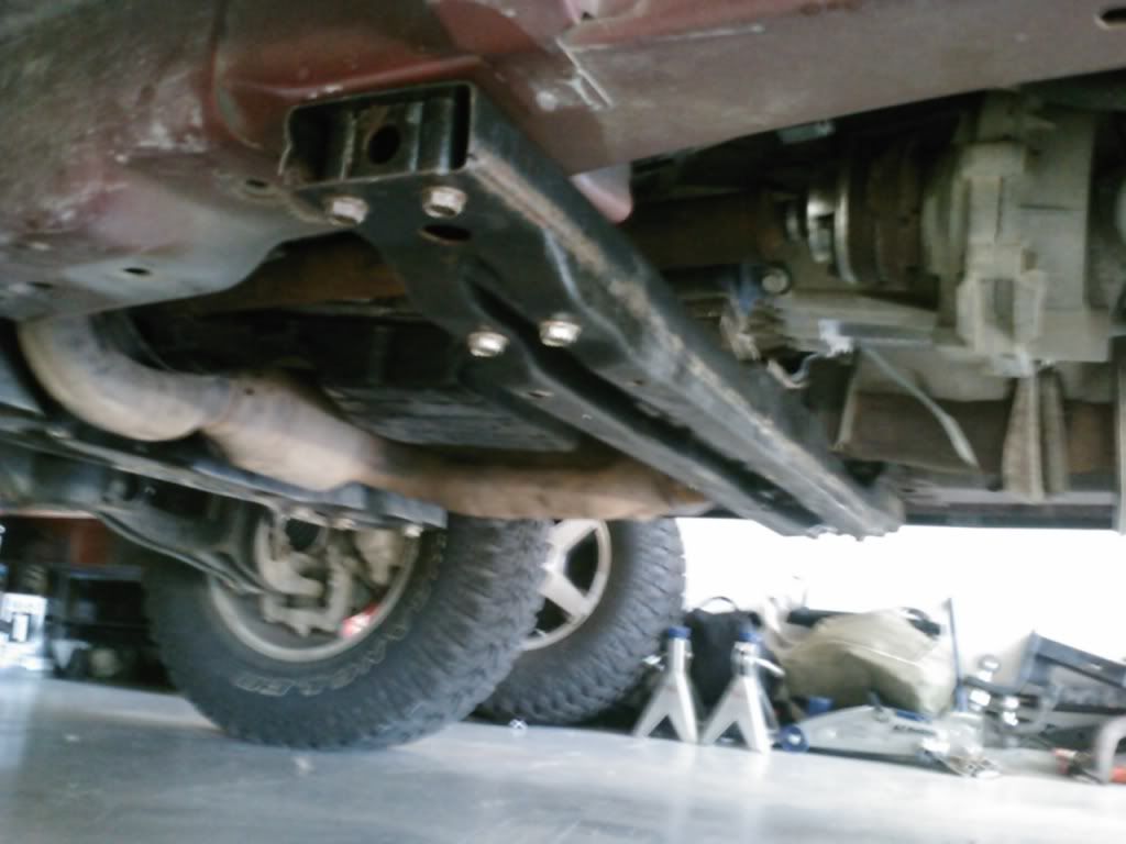

Got everything out from under it and pulled the cross member
Support the tcase:
Each end of the ds has 6 8mm bolts. The diff end is a mother****er to get to all of them - but doable.
Once you get all 12 bolts out and you can't manually collapse the shaft enough you'll notice the tcase end has purchase points to get in and pry just enough to wiggle the ds out:

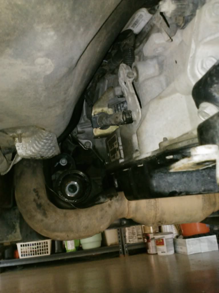

Looking at the diff end:

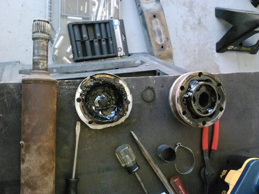

What comes out:
Cv's dissassembled:
.........and this is what I have:

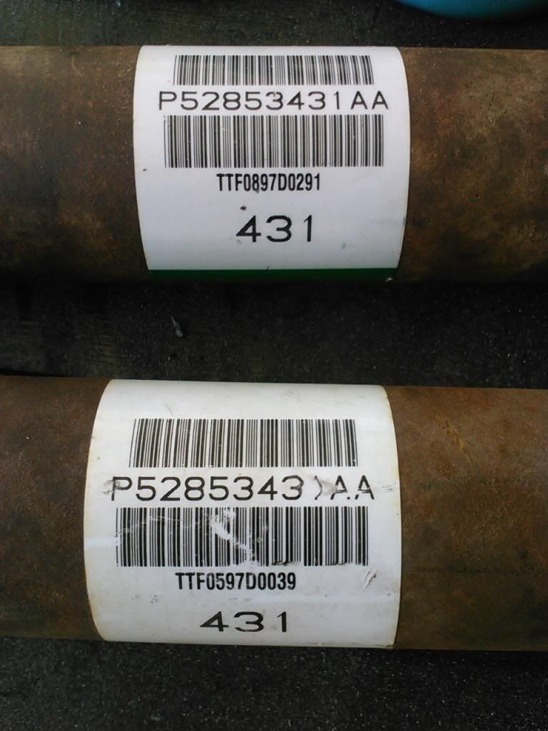

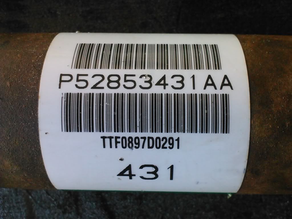

The cv's I got didn't fit my application. The t-case end didn't sit deep enough for the snap ring to properly seat and the diff end just flat out wasn't the right diameter to fit the splines of the drive shaft.
As of now
after
I have an order for a salvaged front drive shaft compatible with my '07 4.7 -
guy says it's off an '09 that had 12K miles on it. Let the record state that to my knowledge at this point - there are no rebuild kits for the cv's on this part number front driveshaft on a WK:

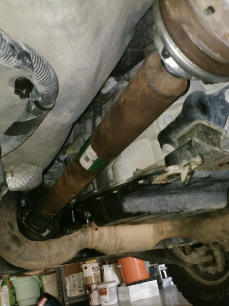

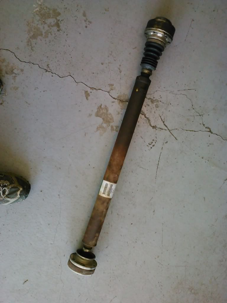

Got the salvaged front driveshaft today:
New to me shaft installed. (Putting the tcase in neutral helps line all the bolts up):
Crossmember back on:
Reengage the tcase and take it for a spin.

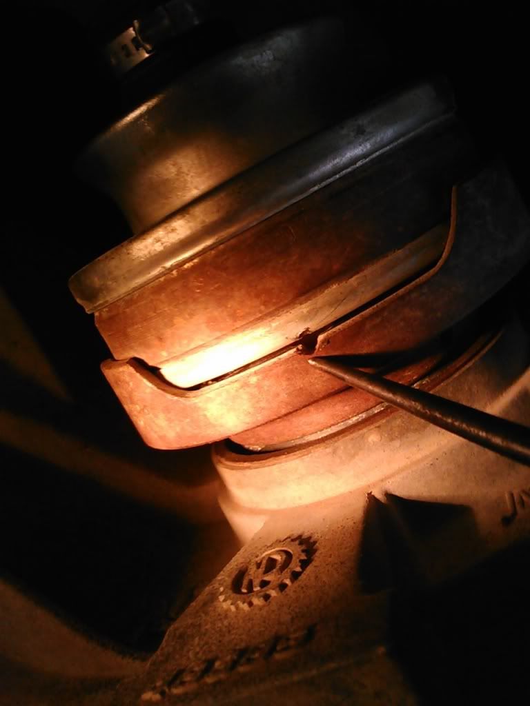

Aside from getting the tcase end cv anew I'm back in the same boat. Diff end is slinging grease:
The same exact thing is still going on at the differential end of this front shaft.
WTF?!?!
There really isn't any evidence of grease coming out of the cv from anywhere but it is definately slinging it. That last pic is after I swiped the "fin" of grease with my finger to inspect it.
I'm really kind of at a loss at this point.
I have considered that adding the Rusty's spacers up front changed the diff flange cup/front shaft cv interface but I'm grasping at straws.

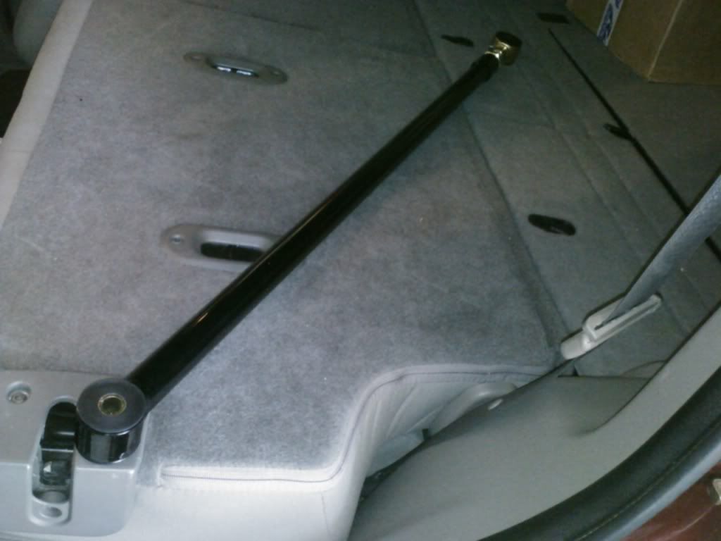

Then I pulled the stock rear tracbar (22mm bolt/nut at each end) and measured:
The pic is off but it measured 40 3/16" eye to eye:
I adjusted the Rusty's tracbar out to 40 13/16" as a starting point.

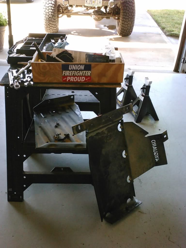

So - this morning I remounted all the armor underneath:
The red Jeep is ready for Colorado!
