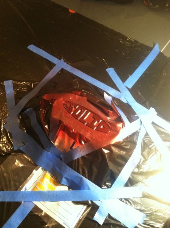

Okay thanks man. I just finished painting the letters. I taped everything else off instead of using touch up paint so I hope it turns out okay. I also read the back of the clear coat once I got it, and it says you must wait 30 mins after applying paint to apply the clear coat. One more thing, must you use non-chlorinated brake cleaner or chlorinated?

The cleaner I used says non-chlorinated on the can. I usually just grab what is on the shelf at the best price when I'm at the store. Never really paid attention to the chlorinated/non.

Okay cool thanks man. I actually got it painted up tonight (almost). I got the lettering done and am just about to throw my fourth coat of clear on in a minute. Here's what I've come up with:

Posts: 7,296
^^^ Very nice - looks like you're ready to put that sucker on!
