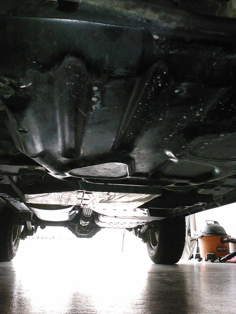

The red Jeep sat cold overnight so today I pulled it in the garage, opened the fill plug on the front diff and it's definately at capacity after drain/refill the other day. So, I buttoned all the skids back up underneath and the WK is ready for winter:

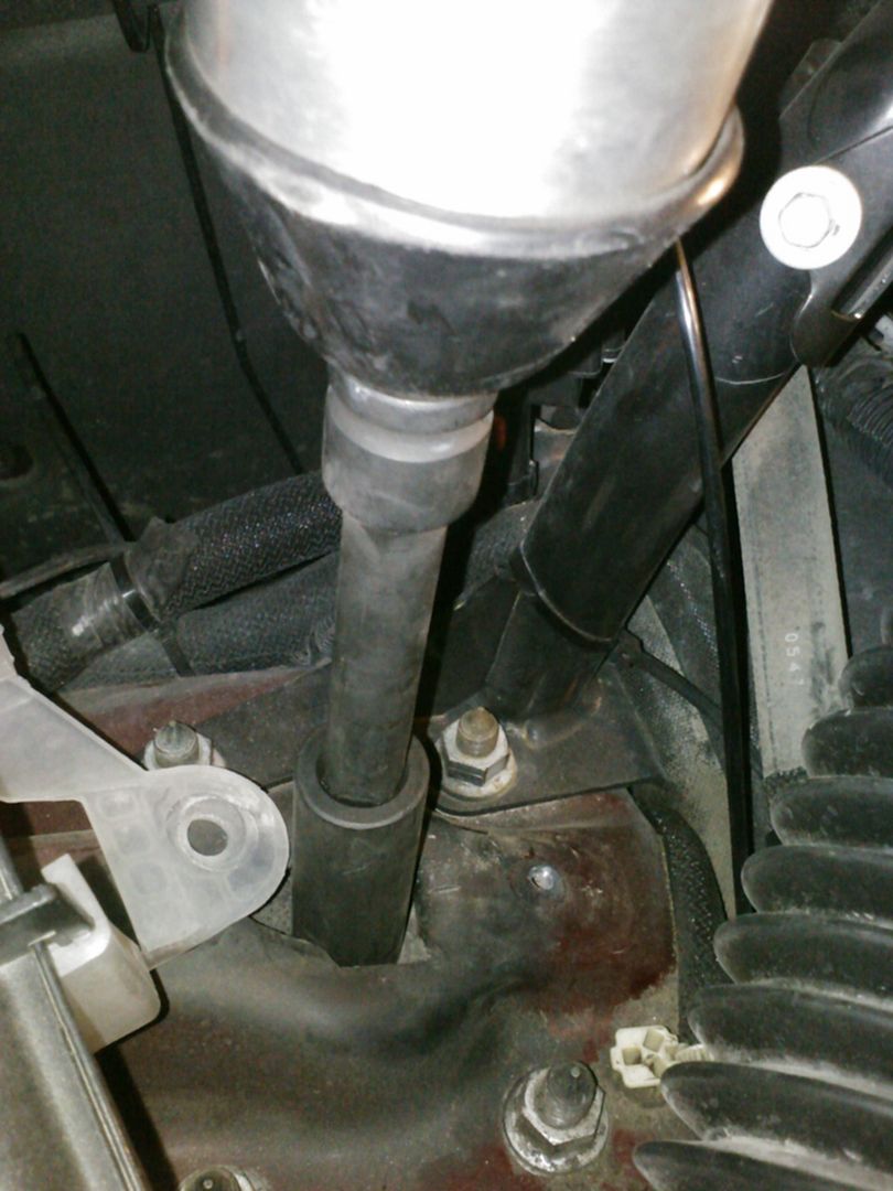

I've had some slight noises coming from the driver front so I took to some wrenching time on the red Jeep today. I made some cuts http://www.jeepforum.com/forum/f67/m...l#post12910826
a while back to make easy access to the top strut bolt and you gotta get all the other stuff outta the way to get the mounting bolts etc. Did this:
Tightened all these down with some air.
Jacked the front, pulled the wheels, hand torqued the rest of the front suspension. I had some tightening to be done on the uca bolts, upper/lower sway links, and sway bar brackets. Clevis bolt/nut was good and so was the upper fork/strut bolt.

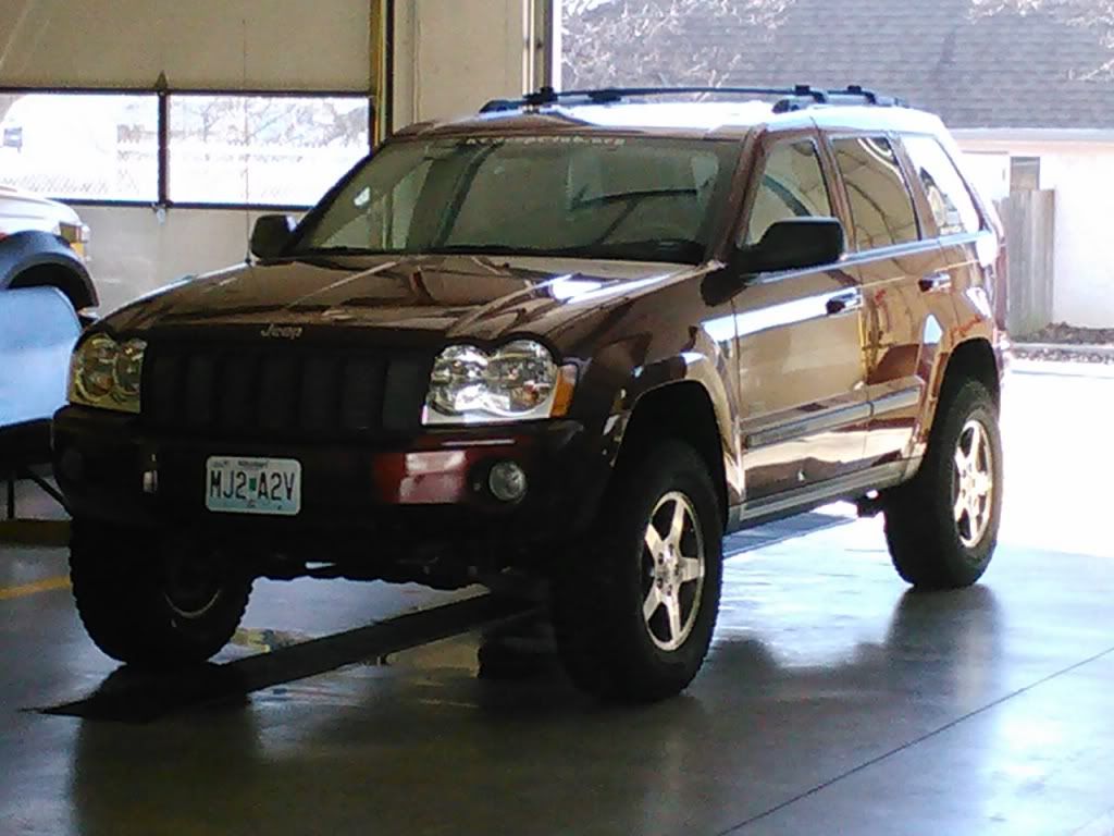

Not the best pic but got it shined up on the outside today.

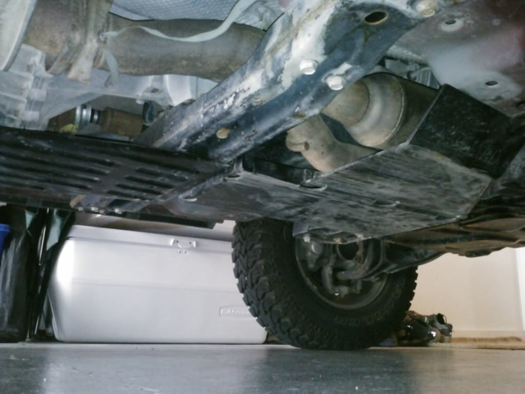

Ready to pull the XJ to a day of wheelin. The WK almost got it's chance to hit the trails. Sunny skies cleared the snow from the roads enough to detail it to haul team. ;-)
