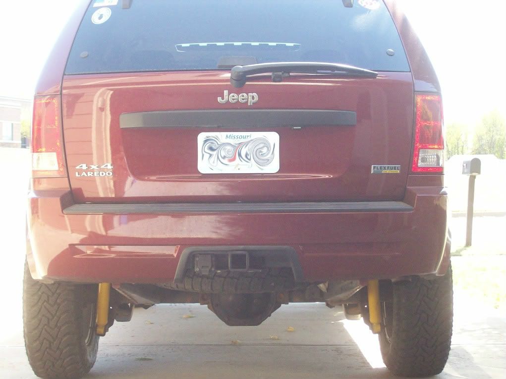

Bought a Nitto Terra Grappler 265/70/17 off a guy on Craigslist so I can have a full size spare. Did the rear hitch modification. Used an angle grinder with a metal cut-off disc to chop the bolts and the reciever tube down, then a zircomium abrasive flap disc to smooth the edges. Finished up with some black high heat enamel Rustoleum (only rustoleum I had). I aired the tire down to 10psi. Supposed to be getting an MV50 12v compressor delivered today that I will keep on hand. May see about mounting it somewhere under the hood.
It's a tight fit but it works:
Tucks right up in there:
