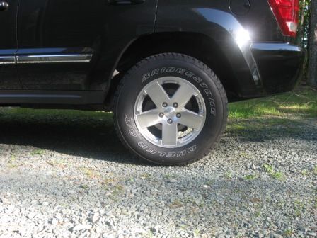

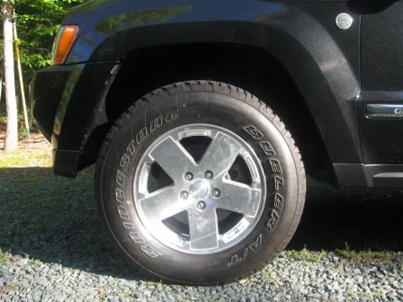

Have had mine for while. Just recently put em on.
Pardon all the dirt, and the crappy pics.

Personal experience with a 3" lift:
No spacers needed for "the bolt", the caliper, or the Pinch Weld with the OE tires 255/70-18 (32" x 10") that came with the wheels. However, they will rub the inner frame rail on full lock either direction. If you go wider you will need spacers.
Others have stated that this remains true even without the lift but I can not confirm that personally.
