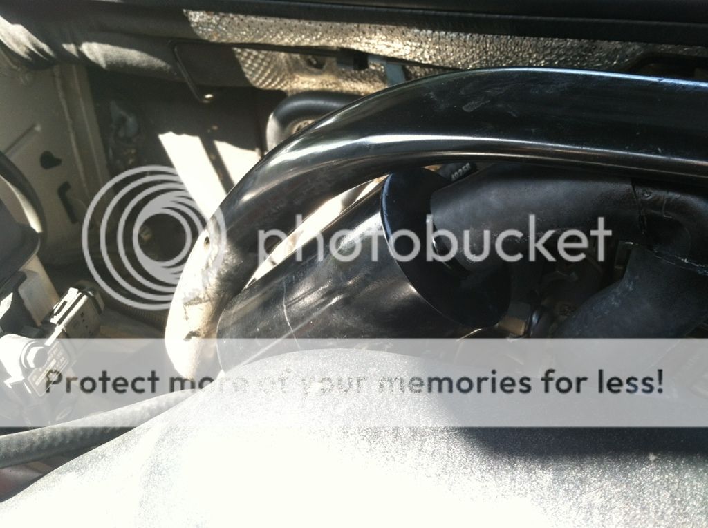

Reserved Throttle Body Delete
Small update, I have been running the intake throttle without the throttle blade for a couple of weeks. No DTC's and its fun watching AutoEnginuity and seeing the % open value change and knowing there's no blade restriction. Not a very noticeable upgrade with all the other mods, but you can tell it's there. Working on pulling the whole intake throttle and replacing it with a 2.5" aluminum delete pipe. The stock intercooler won't fit a 2.5" silicone connector, it is to small so I had to go to plan B with my delete pipe from some extra material before I use the 90. It has the fitting for the IAT sensor and a 1/8 NPT bung for the water injection system.
Throttle blade removed
Out with the old and the eventual new
Delete pipe - simple design from scrap material
On modern diesel engines the throttle valve could be used for regeneration, helping warm the engine when ambient is cold (important for you Canadian guys) and assist with the EGR system.
Silver WK Club Member #1
2008 CRD QT2
I believe it's for egr. That's what they are for on the duramax
...so there is the egr valve and then you have the throtlle valve that controls the amount of fresh air vs egr ??
.... Seems a redondant system / useless to me ...
