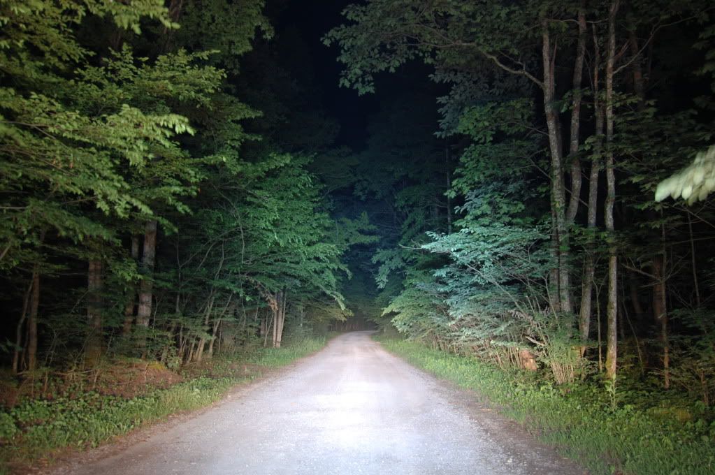

Last night while out on a night biking trip I took some light comparison shots. The three shots were taken at f/5, 3", @ISO200.
I'm running a pair of Hella 500FF's in the grille and a 20" Rigid LED on top. Here are the differences:
Hella 500FF:
Halogen bulbs - 3,300 lumens 110 watts total
Ridgid LED 20" E-Series:
LEDs 7200 lumens, 78 watts total
Low Beam:
High Beam + Hella's:
High Beam, Hella's, and Rigid:

Wow!!! Those are really bright!!

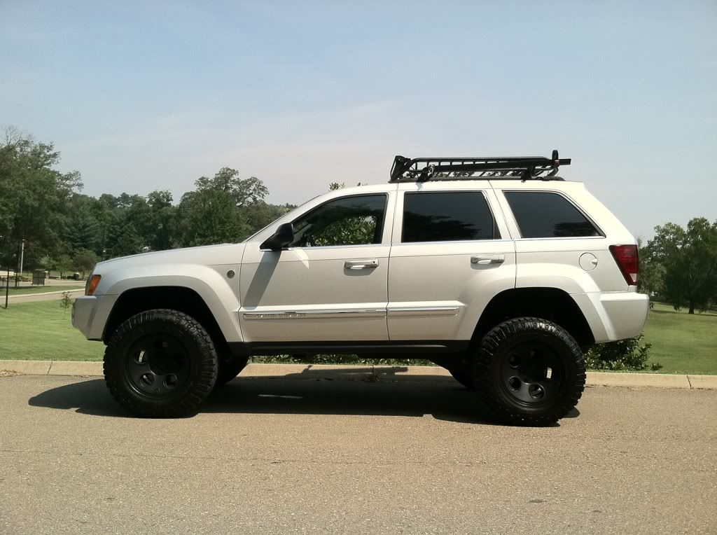

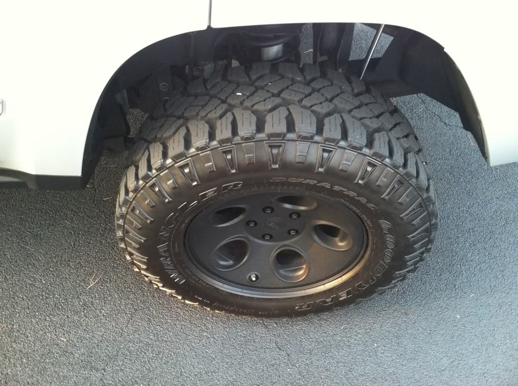

Well I started another phase of my lift. I'm working toward 6" total lift using 2" spacers in the rear and either Bilstein struts/additional spacer or OME front strut/coils paired with the Superlift spacer. I want to run either 285/75/17 or 35x12.5x17 for my next tire. So far I've been focusing on the rear. Installed the 2" spacers:
installed SRT8 sway bars to reduce body roll with the new higher center of gravity. These things make the WK handle awesome. 100% on road improvement! They will be disconnected for anything serious off road.
Next up for the rear I wanted to address the slightly altered driveshaft pinion angle and rear axle bieng slightly forward, so I called up Rusty's offroad and they are making rear adjustable LCA's so I can fine tune it. If I want to run a larger diameter tire, the rear axle needs to move back slightly:
Stay Tuned!
-Jay
