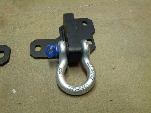

It's a really basic design. I would just take off your bumper and measure the space between the two mounting holes in the frame rail and just cut out a plate of 1/4" steel with the holes placed where you measured. Sorry if that doesn't make sense. I think I have a picture of them when I was installing my S4XC shackles...I'll see if I can find it.
Edit: I don't have a picture of the actual sandwich plate but here's a picture of the shackle. The sandwich plate would line up with the two holes on the right. It wouldn't be too hard to make but you're right, the 4xGuard ones should definitely come with them considering the price.
Ok good info about the 2 bolt sandwhich plate. The $22 4XGuard brackets only have two bolts and I thought it was wrong because of that. It must be correct then. I remember now the oem sandwich plates have two pieces for each bracket sandwhich. A 2 bolt plate and a 1 bolt plate. Why no 1 bolt plate for the single bolt on the other side? I guess a fender washer or two is better than nothing. Comments?
