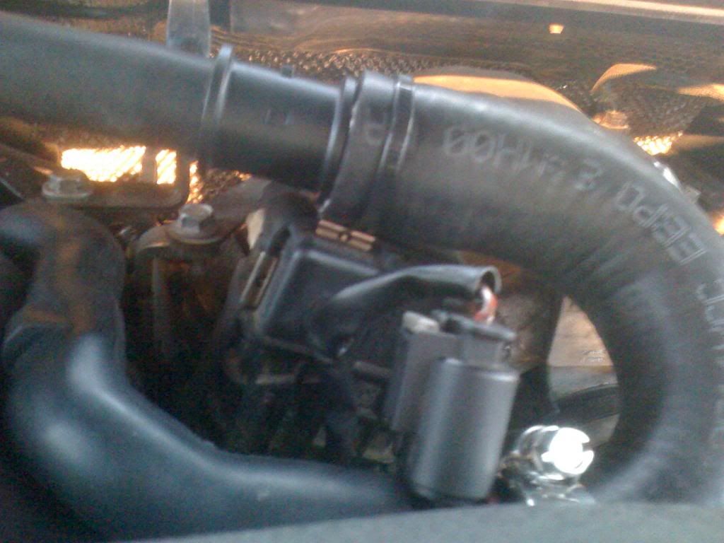

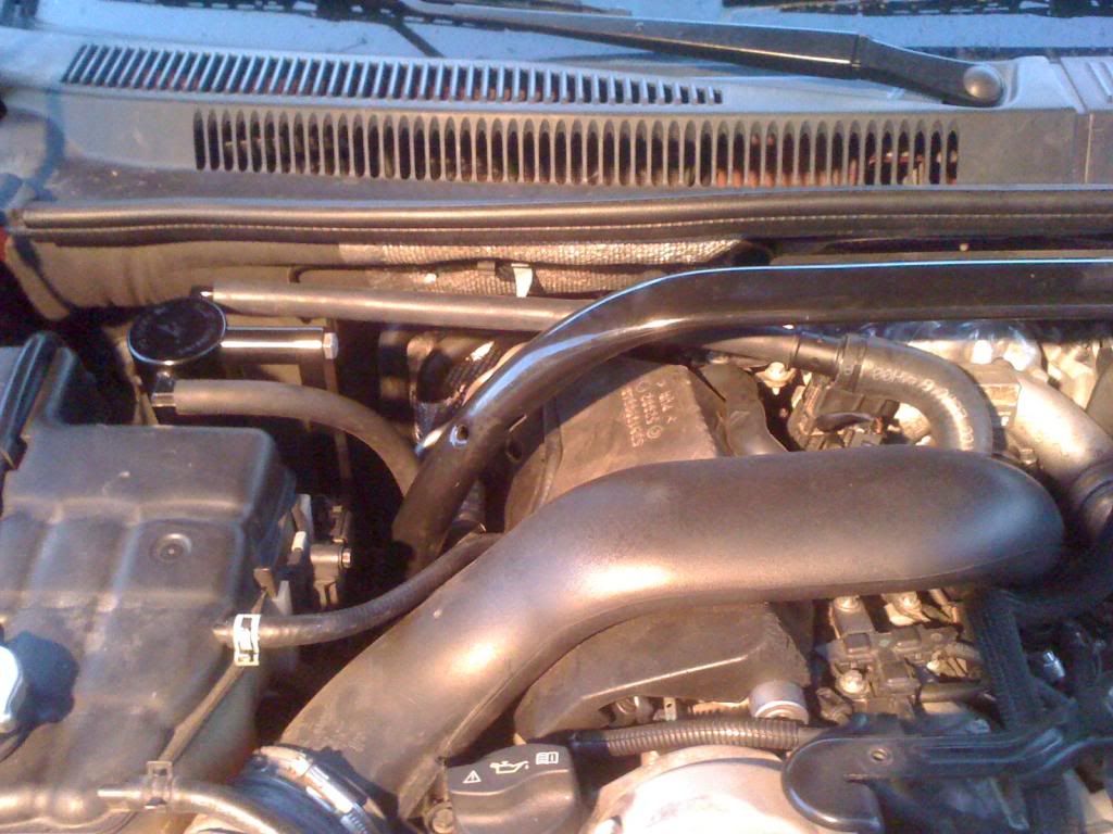

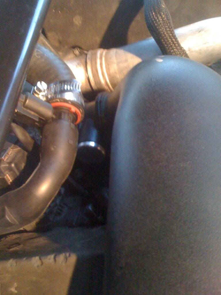

Went ahead and installed the catch can. I used a "U" shaped 1" hose, 1” clamp, a nylon 1” to 1/2" reducer, 5’ of 1/2" hose.
I did not route it back to the air intake as Suzieque did just yet. I just dropped the 1/2" hose from the catch can under the car up front near the front bumper. I wanted to see if there was any visual indication of oil after the catch can. So far after a week no oil indication, the catch can appears to be catching all the oil.
Overall view
Aluminum plug and connection to 1" "U" shaped hose
1" to 1/2" nylon reducer
