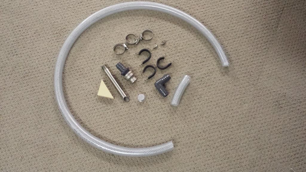

It's the Elephant Hose Mod and all the parts to plug the intake tube and route the CCV into the exhaust.
Wont this just blow exhaust in to the motor instead of the getting blow-by out of the motor? If i'm not wrong, the exhaust has a much higher pressure that the crankcase which is why the CCV is plumbed in to the intake which would then suck the blow-by gases out of the crankcase.
Quite the opposite (sort of), although the exhaust is indeed higher pressure, the exhaust is a vacuum in reference to the blow-by location sucking the line down. Both the intake and exhaust are vacuum in reference to the unpressurized (mostly) cavity.
No, as gemiller stated, it actually creates a vacuum in the tube pulling the CCV into the exhaust. You have to install everything correctly, but its pretty easy. It's called the venture effect. As the exhaust passes the fitting it creates a vacuum. With the end open you can put your hand over it and feel the small amount of vacuum.
