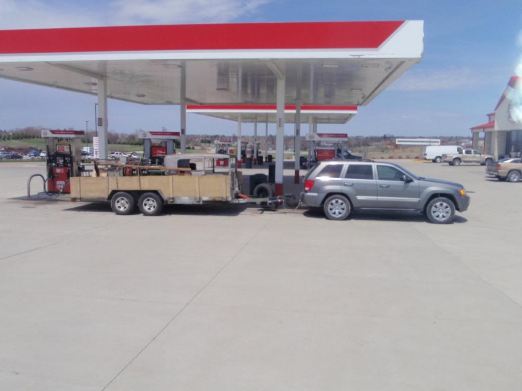

I would disagree with that statement. Towing tunes add performance, but not enough to cause problems. I have always had good experience when running towing tunes on my trucks. I would not recommend running high performance tunes as that can cause high EGT's during times of high load. I have pulled my car trailer with high HP tunes, but you have to be careful not to run too hard and allow high boost and high EGT's at lower RPM's.
I have towed with my Jeep before and after tuning. I have experienced better towing performance after the tuning was installed. I have the GDE ECO tune and I have towed close to the max several times with my Jeep. I have not noticed EGT's that high while towing. Not even close to the high EGT's you will see during DPF regen. Granted I am not towing through Colorado Passes, but I don't take it easy on the steep hills we do have. The higher EGT's while towing would help keep the DPF clean as the high heat is how the DPF is cleaned. The harder you run the cleaner the DPF will be. It gets plugged quicker when not driven hard, but if you were going to do lots of towing I would recommend removing the DPF. You will have lower EGT's and better performance without it.
The GDE tuner can not adjust for larger tires.
Pic of towing 150 miles with a heavy load of stuff when I moved last year +6000 lbs. I had lots of heavy steel not seen below the sides, I beams, c channel. I think the highest EGT I saw was low 900's and speeds ranged from 60 -75 mph.

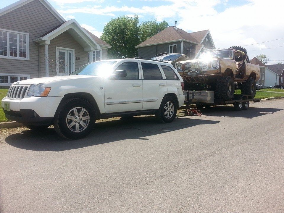

Here's what I towed last weekend with the GDE eco-tune and airlift air springs (to help the fact that I'm a little overweight...) and it ran great! best mileage ever and it followed my friends without trouble (they where towing TJs with ford f-250s powerstroke, rams with cummins and one with a wk hemi at 70+ mph and up a mountain...) So I'm very pleased qith the tune so far...
