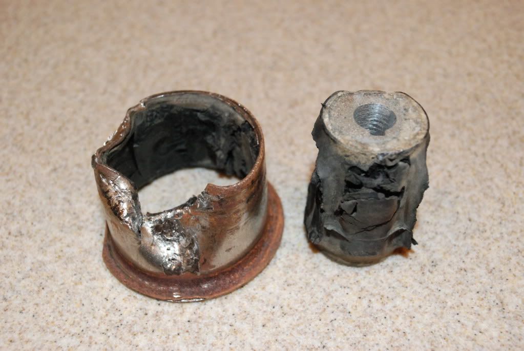

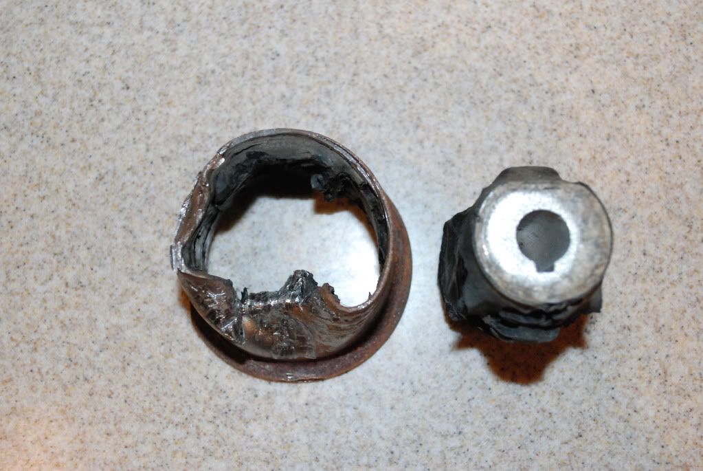

I did this today and what a PITA! I actually had to replace the rear pinion bushing, not the front or pass side. It was very difficult. I opted to unbolt the front driveshaft and the three diff mounting bushings and rotate it around rather than pulling out the half shafts. That was the easy part. Getting out the old bushing, another story. I rented a huge ball joint press kit to try to press it out. It would not budge. I had to beat the crap out of it with a pry bar and after about an hour and a half of that it popped out, totally mangled. The ball joint press worked well to press in the new one. The pass side bushing was in fine shape as was the front so I left those. In total it took about 4 hours with a few breaks, lying on my back with my 14yo son helping out. Thanks Michael!!!!!
Drives so well now, very quiet front end, no more clunking so far. I will test more tomorrow and follow up then. If you take this on, Good Luck!
Sorry no pics of the job itself, spaced that. Here are a couple of pics of the old, worn bushing after removal:

Sorry it took so long to reply, i did this project last weekend, my bushings looked identical to the pictures above when i was done getting them out. the rotating the diff idea does work, but there wasn't any way to press those old bushings out, i wound up using a saw and cutting the rubber out and then using a saws-all with a metal cutting blade, and cutting through the bushing while trying not to cut the differential its self, i jsut went really slow... the actuall pressing of the new bushings in was quite easy using a ball joint press from orielly auto parts. all in all i would never do this laying on the ground again and i would never recomend doing it if you have to lay on the ground (i.e. jack stands holding the car). If you have the ability to lift the car way up in the air on a lift this project would be a million times better and easier i have a feeling. on a side note, having 4 hands was helpfull too.
