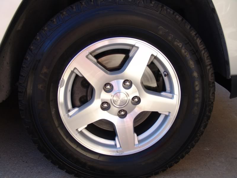

I know you didn't ask, but I found an old pic of the 245/70/17 desti's on the WK if this helps you see clearance.
Thanks, the photo is helpful. I also found a few of jjt250's photos from an earlier post that included a photo of the clearance between the tire and that infamous "bolt". I couldn't figure out how to copy the link here though.
