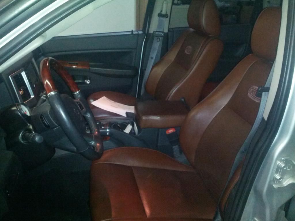

Hey guys! My name is Matt Whitbread, I'm new around here but not to the automotive world. Good chance that anyone here that's also in the VW/Audi world will recognize me. Anyway, I have a fleet of VW TDI's and I've been looking for a crd jeep for a long while. After much looking, I spotted an 08 Overland CRD from Milwaukee with 89K last june and went up to grab it. It was bone stock until last week, no more .
Rare black/brown interior (at least from my readings)

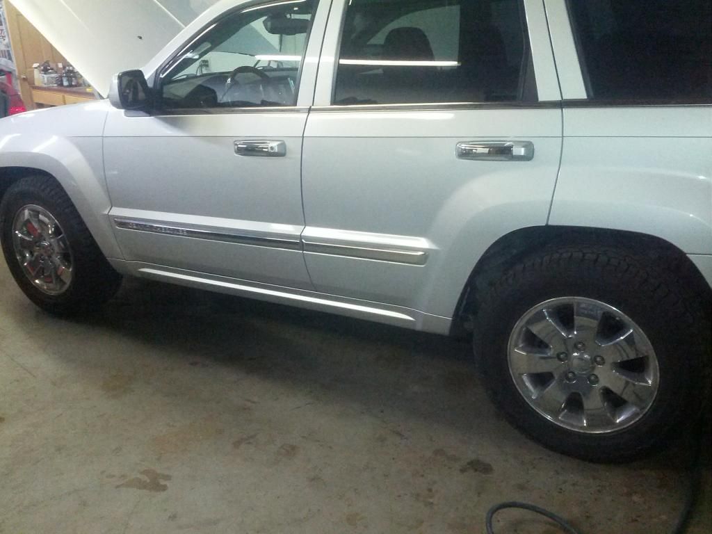

Went up to 265/65-18 hankook dynapro atm's. Now it needs some bilstien front shocks to level it out.

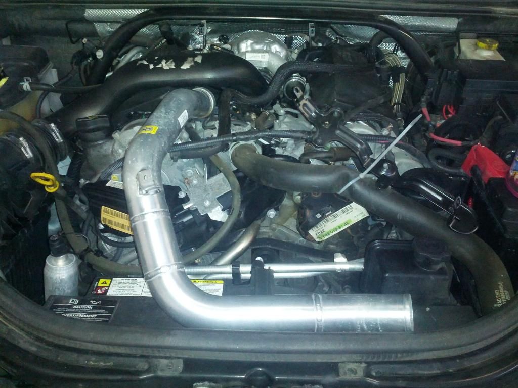

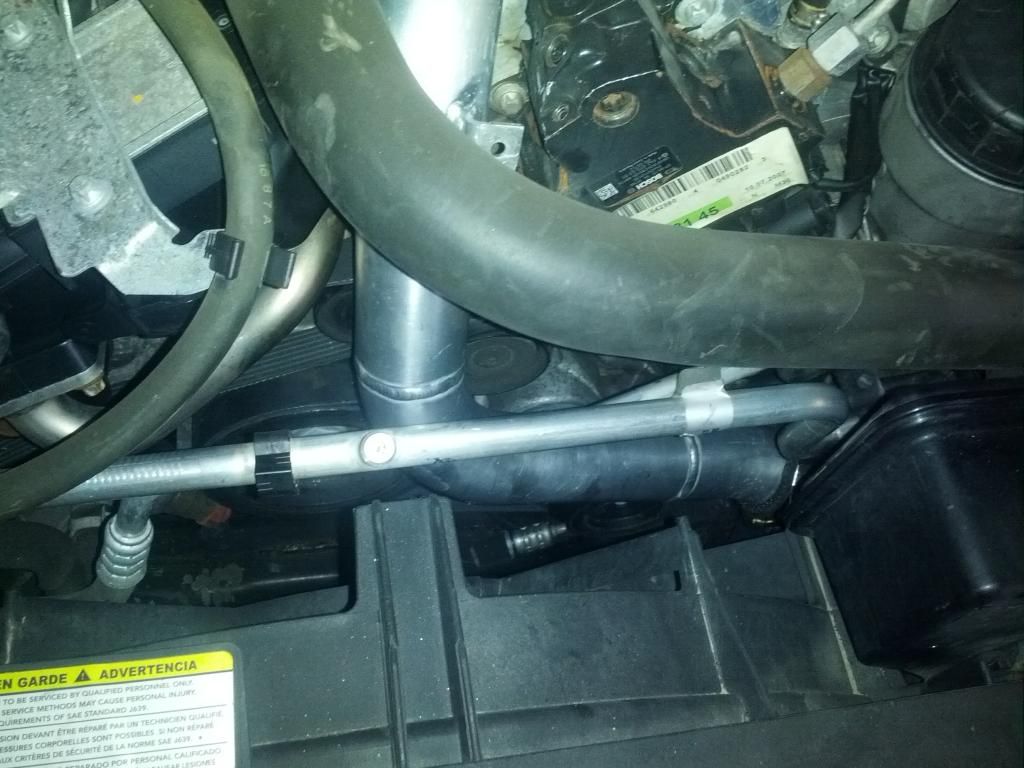

Did the first oil change and serpentine belt change today. When a fabricator and a crappy plastic component meet, there is only one possible outcome.
From here, it's going to get a gtb2260vklr turbo from the HO merc motor, full 3" ss exhaust, better turbo inlet pipe, and a bigger intercooler. GDE happens to be 40 minutes from me so that will make the tuning very easy.

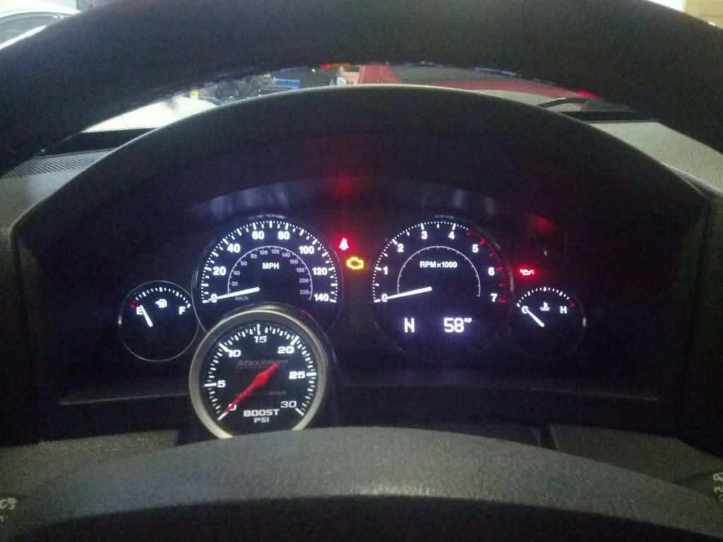

Nice rig. I'm in Milwaukee and had to go to Colorado this spring to find mine. Digging the boost gauge, reminds me of my 01.5 Audi S4 placement. Looking forward to seeing the turbo install.
I didn't even notice that. It does look nice!
I use DashBoss with an old iPod Touch on a mount via bluetooth to get readings: trans temp, coolant temp, boost, batt v, egt... the stuff you don't get to see real numbers for. It does not read oil pressure or oil temp, but the dashboss dongle has two additional connectors so I could tap a oil pressure and oil temp sending units into the engine and get those readouts with the dashboss.

Thanks! The PO actually made the pod and had a beat up old volt gauge in there. He plastic welded a universal pod to the top of the steering column cover. Came out nice enough that I have no reason to change it. I just put a stewart warner 0-30psi boost gauge in there as I had it laying around from an upgrade on a customer car. Put a white led bulb in it to get it to match the factory cluster.
