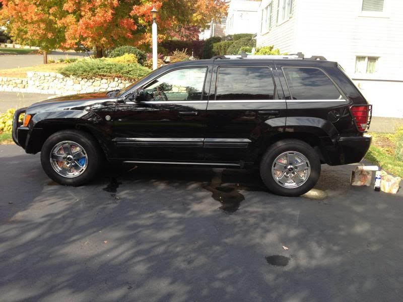

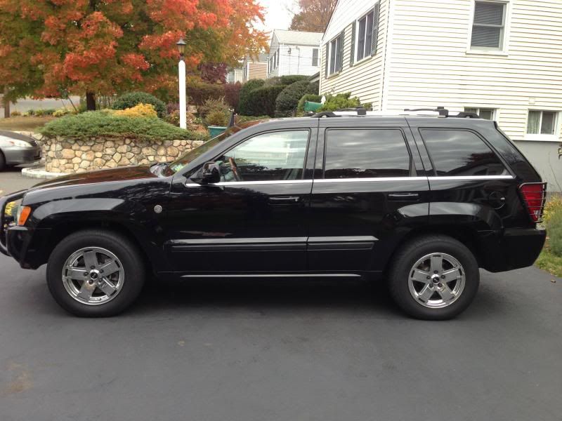

The first mod I performed was the removal of the front air dam which I thought made it look alot better. Plus it was free. Always a bonus. I also added a 5.7L badge to the back.

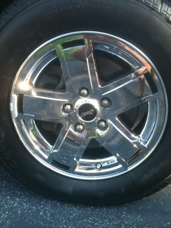

Next, I decided I wanted to try to do something to make my wheels stand out a bit without going and spending a lot of money on new wheels so I ended up using a rather unique (I believe) silly putty method to paint my center hub caps:
I lined the letters with silly putty to keep them silver.
And this was the result:
While they came out well I decided this was not enough and went ahead and painted the indents black as well. Taping and sanding and papering the wheels took quite a long time and it was night by the time I put on my second coats.

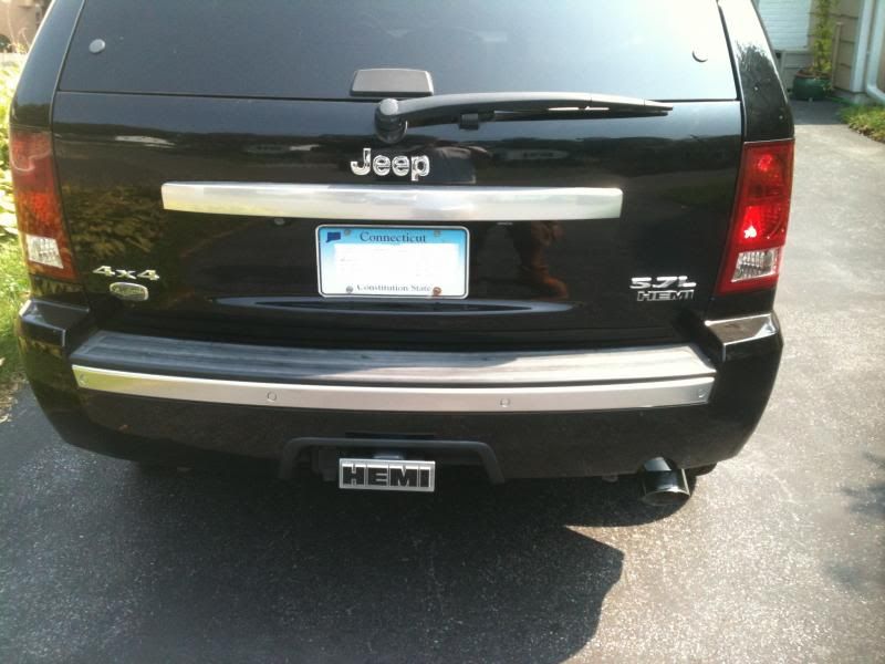

Then came the exhaust purchase. I got a great deal on the SS Gibson Cat-back from Kolak. I was pretty excited when this box showed up as I knew the stock sound of the HEMI was not anywhere close to its full potential.
One thing I like specifically about the Gibson is the fit and angle of the exhaust tip as it protrudes from the back bumper. Not to mention the sound I have some phone videos if anyone is interested, but believe me when I say the REALLY do not do it any sort of justice. It is a great low rumbling sound and I would definitely recommend it. It also quiets down when you're off the gas as to not be too annoying to neighbors or quiet areas. It fits my needs, although I am toying with the idea of electric exhaust cut-outs for when I REALLY want to let the hemi roar. But it definitely has a lot of grunt when you flex it as is.

(Also got that hitch cover which served me well for a while.)

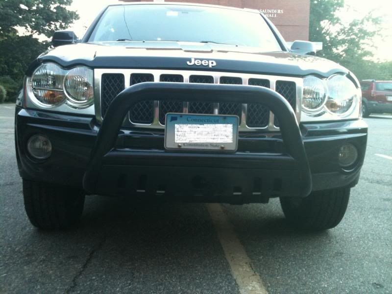

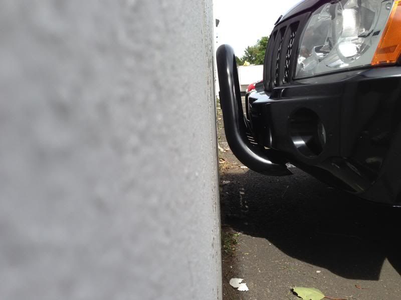

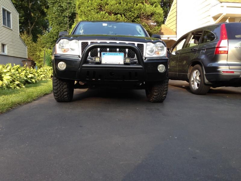

After that I decided I wanted to purchase a bull bar, so with some guidance I went for a Black Horse model. It was my first time tearing into the front end and I learned as I went that I was missing certain tools required for the job lol. You live and you learn!
Oh, yeah, the reason I had to break down the front end was to take out the factory tow hooks which I sold to a member on here a while back, maybe 2-3 years ago.
I really liked the way it looked from the front especially, even if it didn't add much utility besides light mounting points (which I will get to).
This pic gives an idea of how it sits from the side, I have since been able to move it a bit closer to the body which I think made it look a bit better. This shot was taken as I got out of my car to go into the gym one day and realized how freakin' close I parked to the wall. Lol.

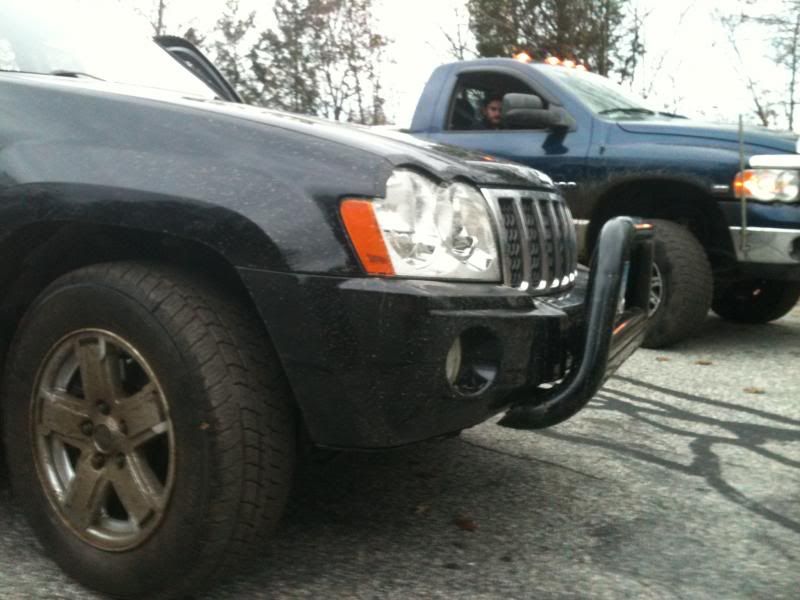

This is a quick pic of the first time I went off-roading (or after the fact). Shows the bar from a different angle.
I didn't realize at the time what a monster lift/tires my friend had on that Ram. lol. I was definitely a bit silly for following him through some of the stuff, but the Jeep held it's own.

After that I decided my brush guard needed some lights on it and I had always loved the design of LED light pods. Being too cheap to opt for Rigid Dually's, I found some much less expensive options from Illumination Supply. I went for their Spots as opposed to Floods. They also had the option of coming with a wiring harness which I found very helpful indeed.

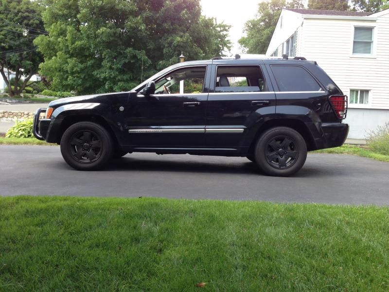

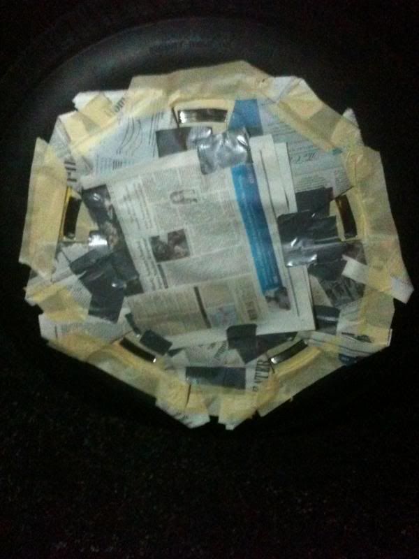

And that's about the time I decided having black wheels would be cool. Soooooooooo that project got underway.
Before:
After washing the wheels off and putting newspaper in between the gaps:
Anddddddddd after:
I put about 6 or 7 coats on there, which is definately reccomended. When I went to un-dip my grille, I realized I only put two coats on and it was a HUGE pain to take it all off. You really can't over-do it with plasti dip. Also, another note, it would be much easier to use those clear plastic bags you get in the grocery store in the fruit aisles to put in between the wheel gaps than newspaper. The newspaper was hard to get in and out without scratching the dip. Just a tip.

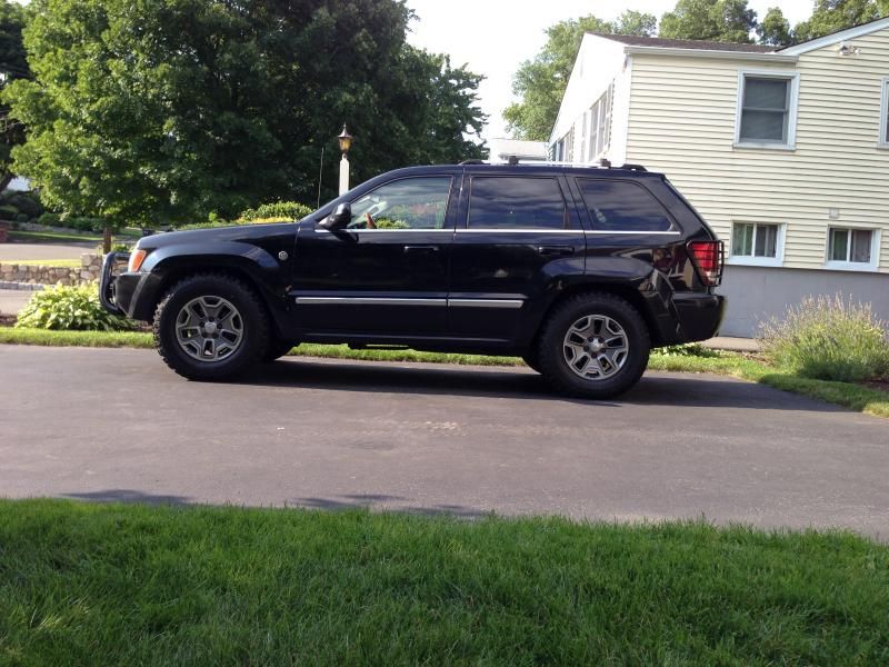

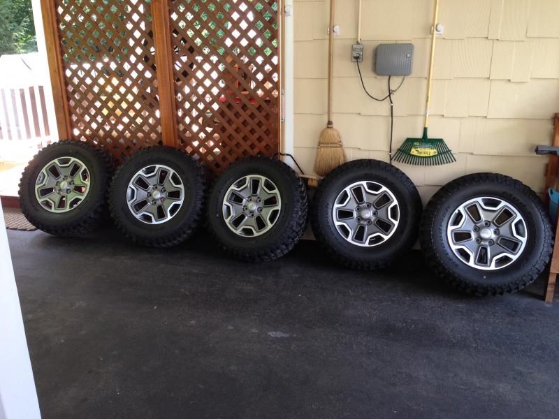

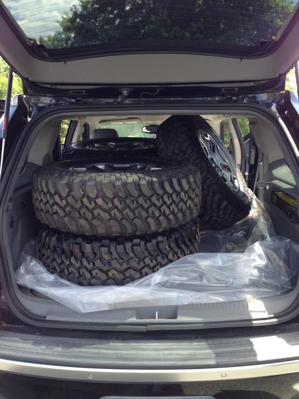

And then around 7 months went by without much modding, and I found a great deal on a BRAND new set of 5 2014 Rubicon wheels and tires on Craigslist - a state over. The guy I got them from in Jersey was very nice and his wrangler was kick-***. Brand new and lifted with 35's. So I scooped these babys.
Was a bit concerned they wouldn't fit stock even after having talked to a fellow member who did the same thing lol.
I like this little touch, I suppose the dealership put them on there haha:

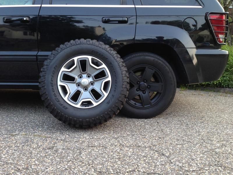

So anyways, I went ahead and mounted the 32's on my stock suspension WK. The tires are 255/75/17 BFG MT's.
Before:
After:
With the help of these guys and a torque wrench:
I gained two inches of lift from the tires alone measuring to the bottom of the side skirt thingymajig. 12" stock, exactly 14" with the new tires.

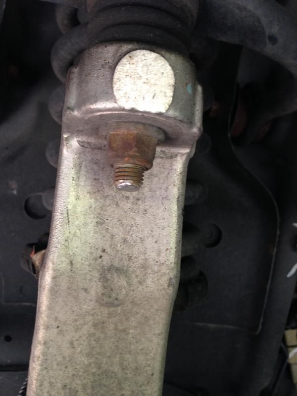

They do fit perfectly fine unmodified, aside from a SLIGHT rub at 3/4 turn on the pinch weld. It's really not an issue though. I was very surprised. They also cleared the UCA bolt by literally the width of like two quarters. Lol.
I drove it that way for a while and then decided to put my mind at ease and trim the bolts. Again, this is not necessary, but I feel better now.
It doesn't look it, but the end result is super smooth due to some Dremel sanding.
The tires don't leave much room for articulation as you might imagine, so my next project will be a lift Leaning towards full OME HD, possibly some sort of modified OME.
