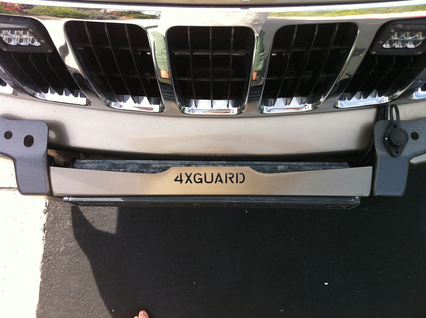

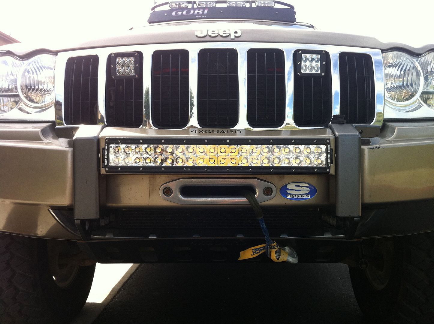

Actually no, I didn't take any pics as I was doing it I basically took a 20" Rigid E series (kind of pricey unless you can find one used) and mounted it right in the middle of the crossbar on the Matrix. Then I drilled new holes for the crossbar and the two vertical sides so the front and top edges would be flush instead of recessed like it normally is. That gave my just enough room to mount the Matrix back up in front of the bumper. The back of the light touches the bumper, but thats no big deal.
If you are looking for cheaper upgrades this is probably not the one to look into. The light bar new is $500 and the Matrix is $330. But if this is one you want to go for, let me know and I will disassemble it and get better pics

Next, a much more labor intensive task, is a winch setup. Now, I love Omelet's design of the integral winch, but I want the ability to easily apply pressure and watch it feed back into the spool so it doesn't bind up, and want to keep the cable in the best condition possible. This leads me to a few options I have been considering and want your opinions.
1. Mount a winch upside down on the bottom of the cross member so that the cable comes out of the "bottom hole" in the front bumper. The problem I see with this is the dynamic strength of the pressed metal cross member, which worries me. Is this option even feasible?
2. Use a hitch mounted system so that the winch can be placed on either the front or rear of the vehicle. None of the current plates/systems are appealing to me, so this would mean fabrication of a new winch plate and attachment. Is this something feasible? I think it would be cool to have the winch nest into the "cradle" in the center of the front bumper, and put some steel plates along the sides to make it look much better? I a working on a draft right now for an example, ETA within the week. However, how will the hitch option fare when I have a 9k pound winch working overdrive? Will I have any warping on the attachment points?

You could fab your own mount, but you cannot mount to the existing crossmember. That will have to be replaced if you go hidden at all. Also, I can easily see my winch spool in and apply pressure because I can see it through the grill.
A hitch mounted winch is an option, but don't forget they are heavy and it will affect your approach/departure angle if left on while wheeling.

^^^What he said! I can see the drum either through the grill or by looking straight down the hole I cut for the clutch lever access.
