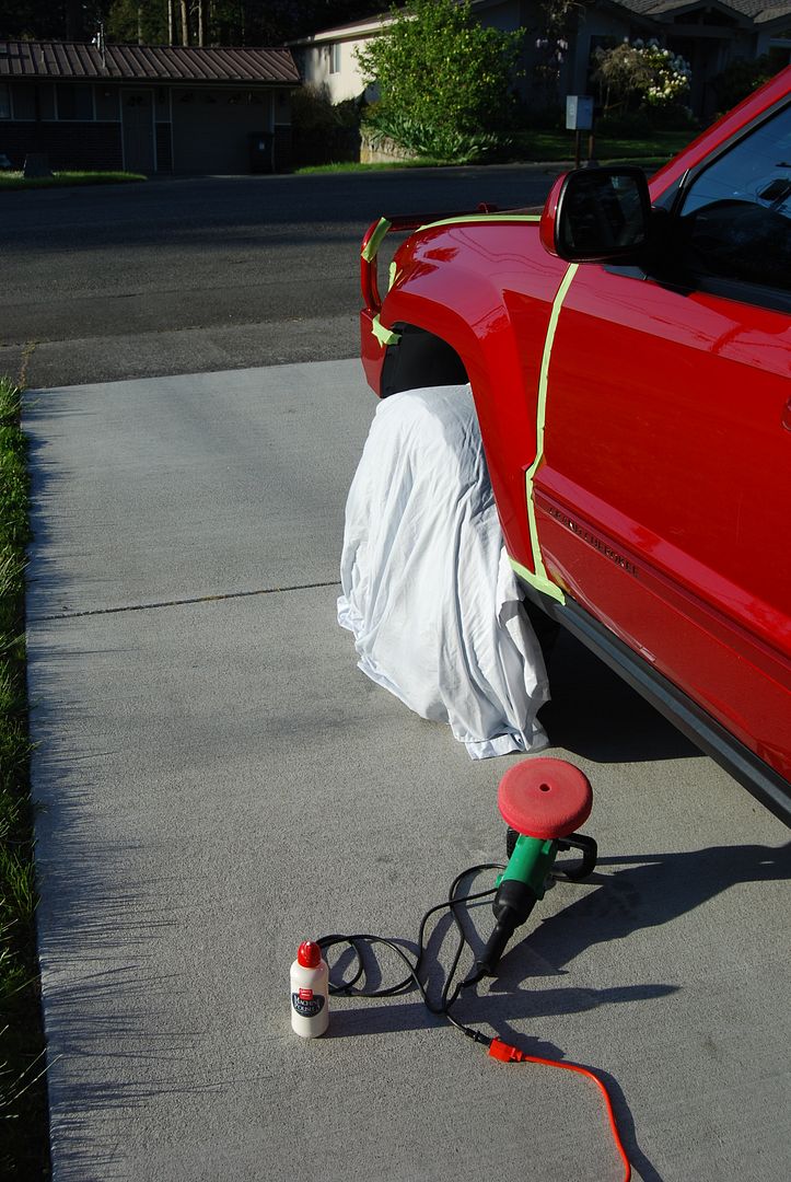

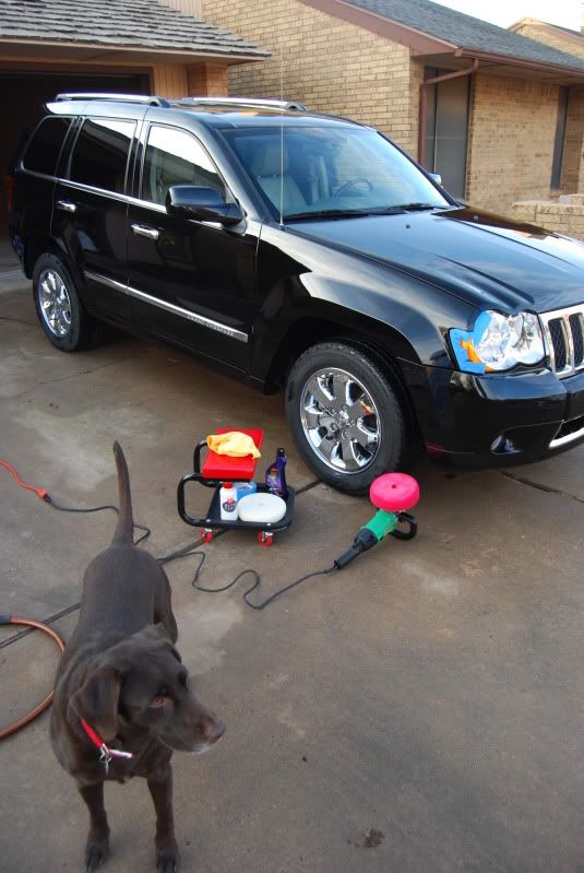

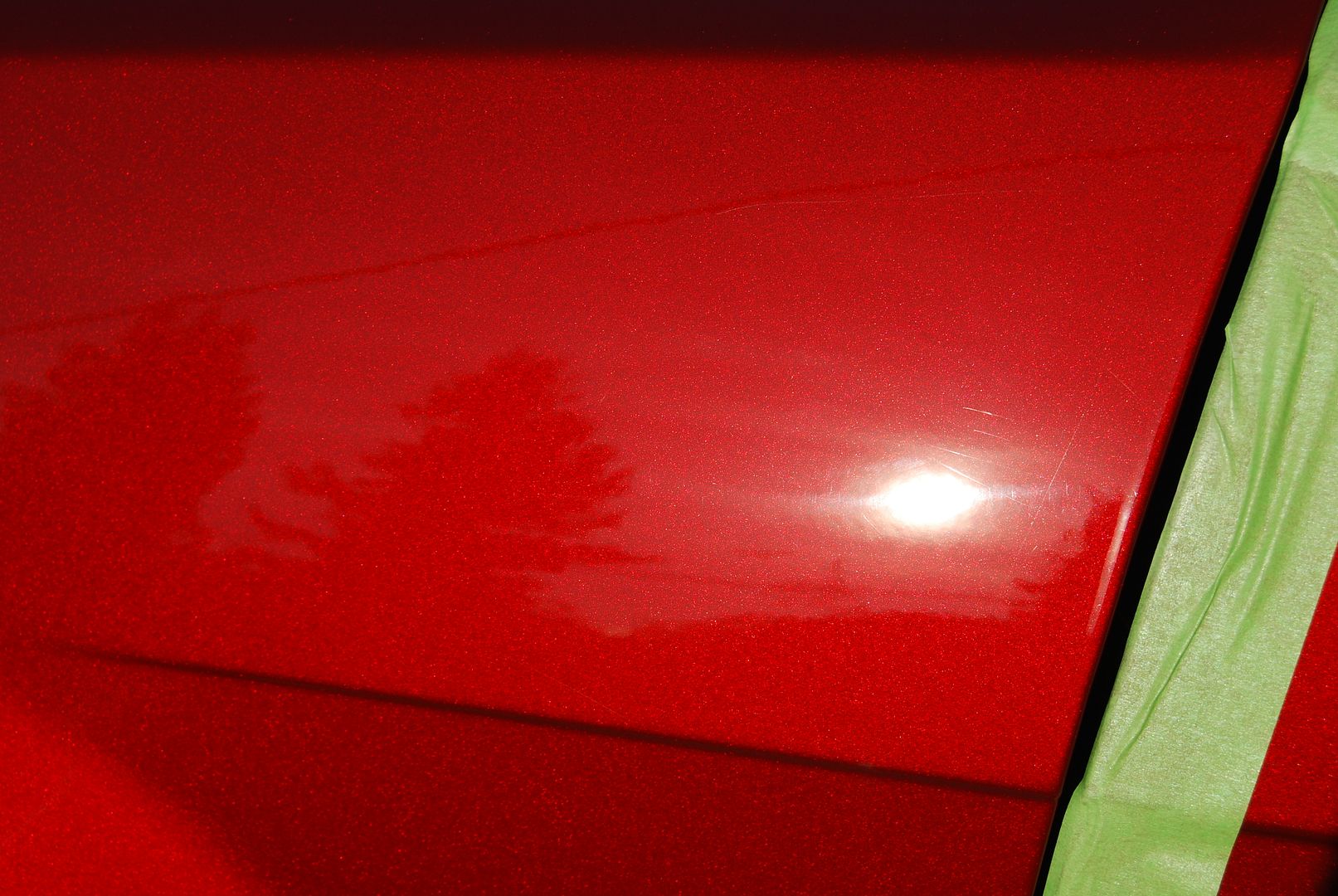

I'm also a big fan of keeping things clean when I'm staying on the pavement for a while. I detailed at a Porsche dealer for a few years during and after HS but am mostly too lazy to go that in depth... Every once and a while though:
The old '08
Getting a good buff and wax just before deploying:
One thing that I've found is that most people opt for a cheap buffer... Or really, a cheap grinder/polisher. I've always said that if you want a real buffer, you should be expecting to spend over $150. A grinder/polisher is not meant to buff... they typically don't offer the same level of speed adjustment and precision which can lead to burning through paint. My weapon of choice is a Hitachi with either a Meguires or a Milwaukee pad with Griots Garage and or 3M compound. I've recently added a Griots Garage 3" random orbital to the arsenal and am a big fan... I use the Hitachi to make quick work of large surfaces and the Griots for the small hard to reach places.
