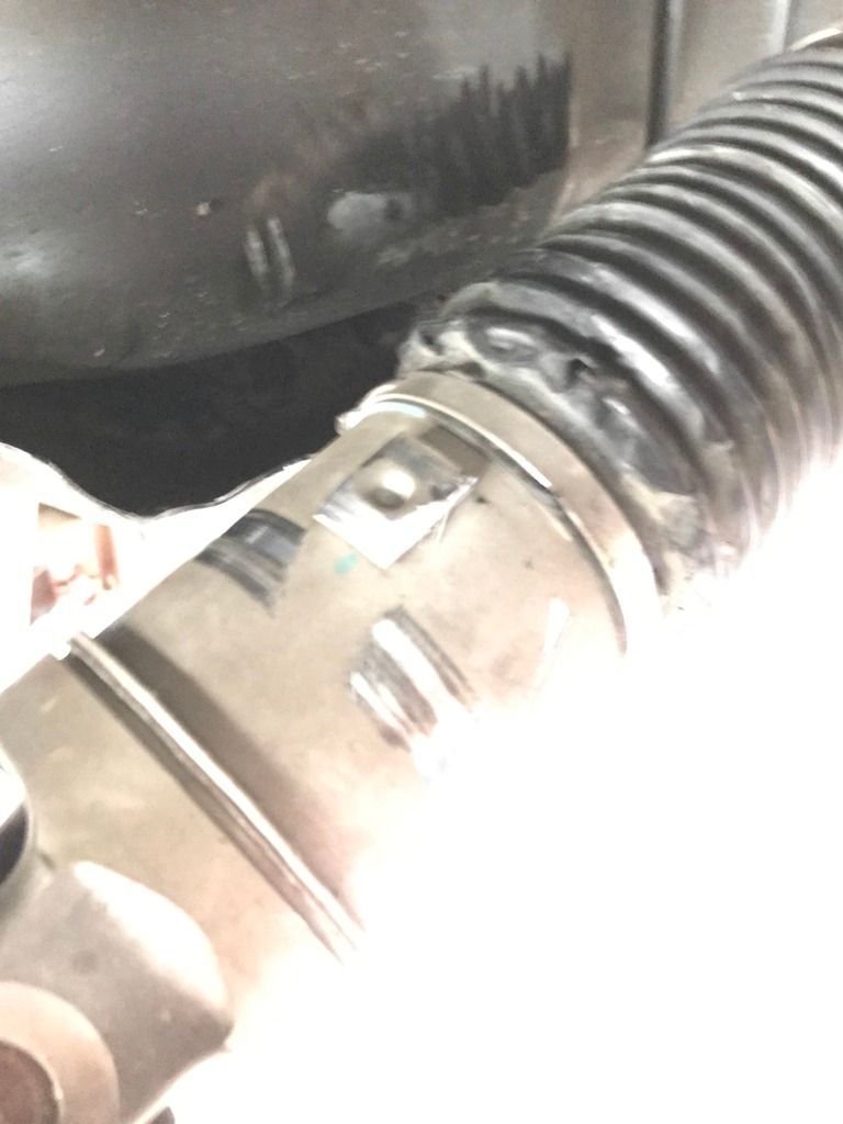

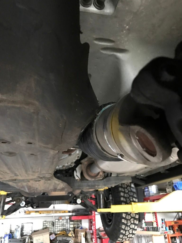

So I just came off of my spring break, and I got some stuff done. I installed strongarm lift gate and glass hatch struts since all 4 were practically dead, and it's a major upgrade. I finally changed my rear trunk light mod from that useless blue to white, so I can finally see at night (very easily I might add).
Here are some pictures I took of my CV angles, and one with my mom's WK2.
I got bored over break and pulled off my rear sway bar. The bolts were a b**** and a half on the driver's side, and so was finding a way to pull it out, but it's off. I would highly recommend taking off the links first. When driving (aggressively on turns to test it), it had a tiny bit more body roll, but nothing I would worry about. While doing this, I discovered that I have the OEM fuel tank skid even though my WK isn't OEM towing package or trail rated, so that saves me $300!

Sorry for the hook question, since I've now read the rest of your thread. I'm glad nobody was hurt and I like how your build is turning out.
I have the superlift, and I had the driveline hit the fuel tank skid, which it seems you're aware of. This picture should give you a clue how much to cut off the skid plate.
