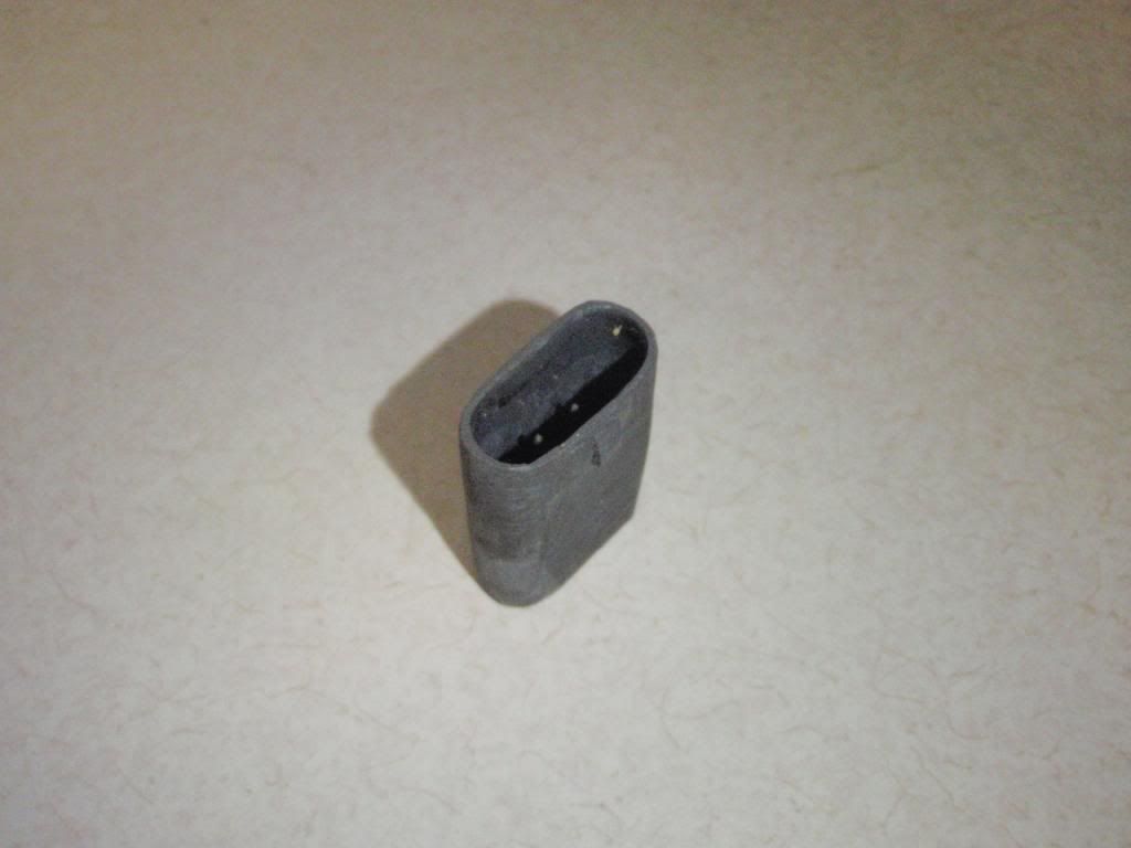

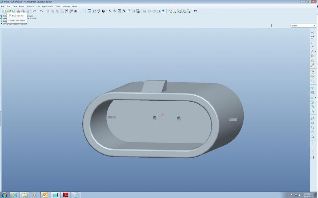

I have made a couple for myself. I just couldn't wait for one of these. I have been testing it for a couple of weeks to make sure I don't any problems. I machine mine, but am looking at using a 3D printer or just machining some more. I installed the resistor with some pins to interface the stock plug. It is totally waterproof and will keep the connection from corroding. I made a prototype to make sure it fits correctly and machined a clean one that is actually in my Jeep and was what I have been testing. I still have to figure out costs and stuff like that.
The CAD design.
My first rough prototype
