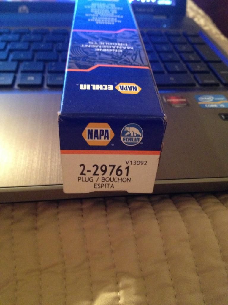

OK, don't crucify me, but I purchased a Echlin GP from Napa and installed this morning. I was getting a P0673 fault code, GP#3. So I changed the one closest to the firewall on the passenger side, and it was a faulty plug. The plug that came out was a Beru, with a Merc logo on it.
This is the fourth plug we have replaced, 2, 4, 5, and now 3. I decided to go this route instead of the 150 the stealership charged me last time.
Anyone have any experience with these GP's? I got mine for 26.99 per as I bought 6, and they have a 3 year warranty.
CRD Owner is offline

No comments??
The light went out after 2 days, so far so good.

I don't know if it is good or bad but that would have been my first choice because of the convenience of it. They are practically next door. So I won't throw the first stone.

If the GP works then it was a good choice.
