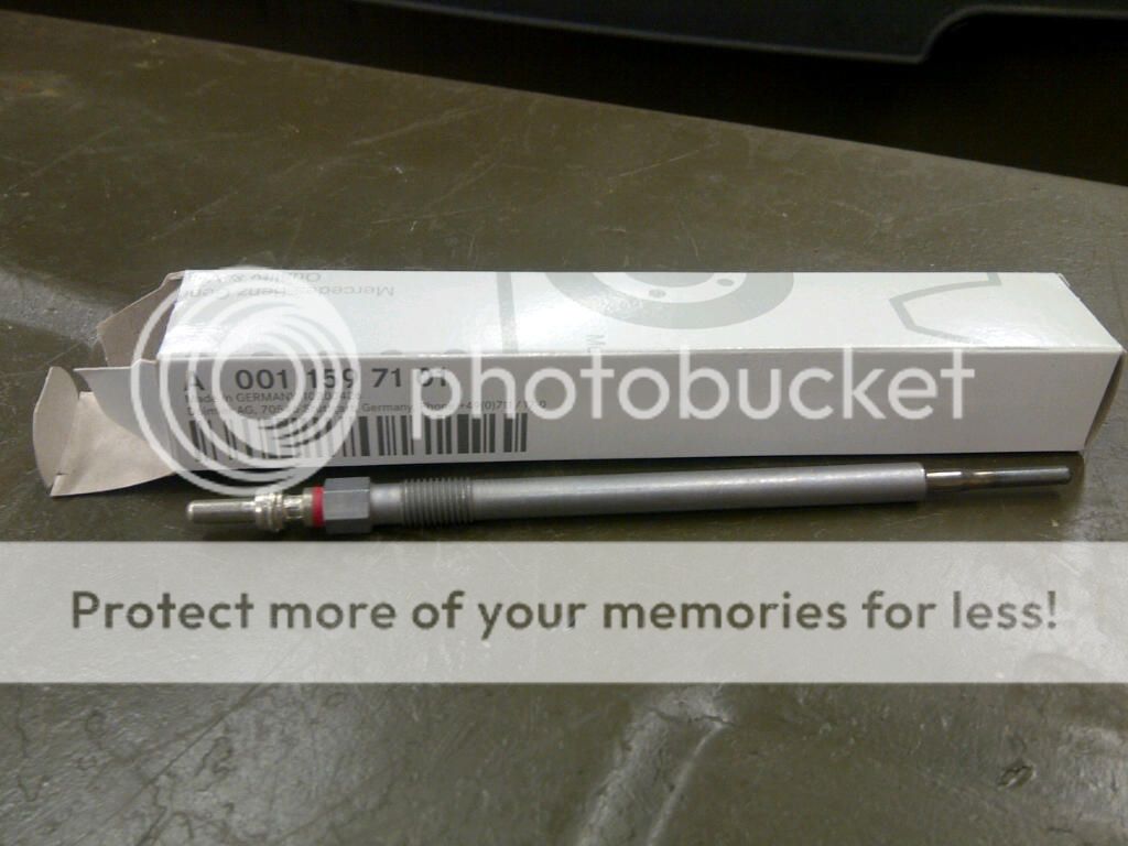

My CEL came on yesterday and according to my scan tool my #5 glow plug circuit was bad. I picked up a replacement from the local Mercedes dealership here in Cornwall, Ontario for $31 + tax. The local Jeep stealership wanted $56!

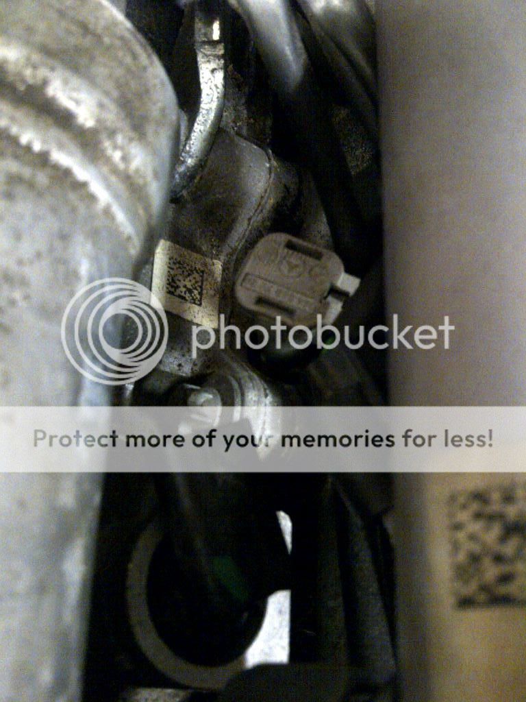

Luckily the #5 cylinder is easy to access but I did disconnect the the electrical connector just ahead of the glowplug connector to give me a little extra slack in the wiring.
I hate plastic connectors. I used a small set of needle nose pliers to remove the glow plug electrical connector and while it worked i did slightly mangle the tabs. I think the proper tool would make the job easier.

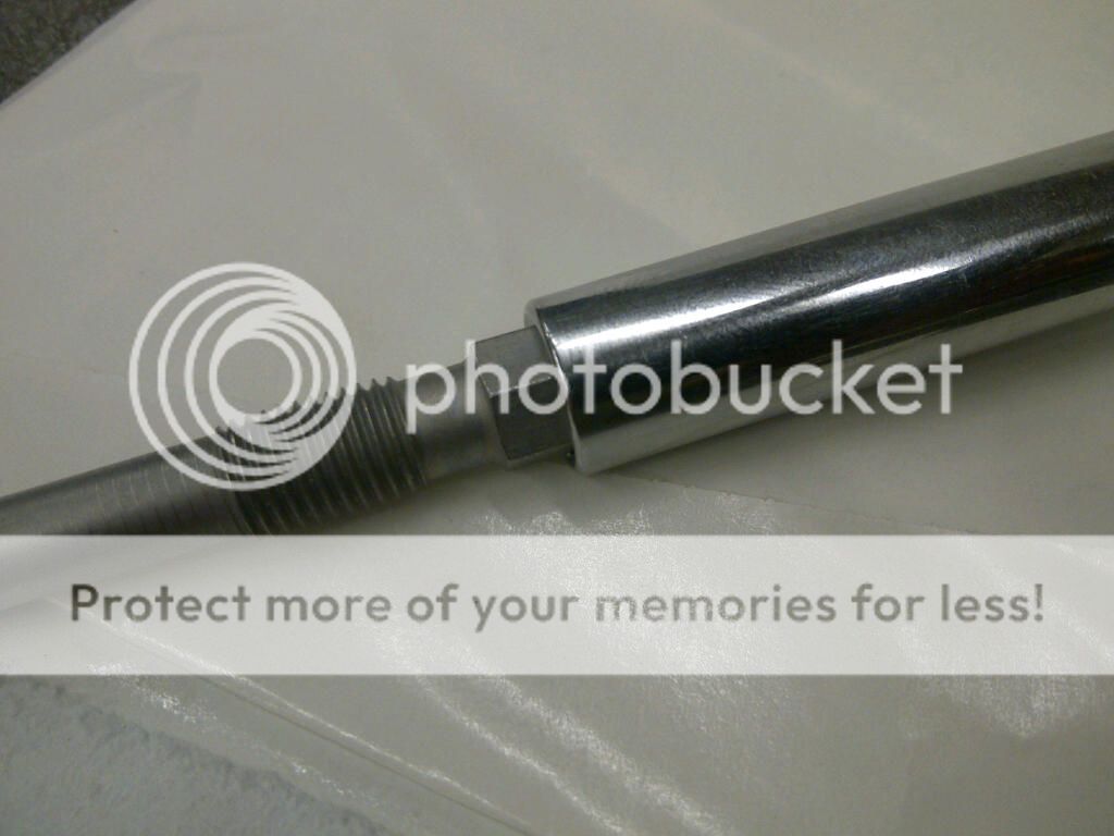

I used a 8mm deep socket but discovered it didn't slide over even half of the glow plug hex. With a torque wrench I tried carefully and it came out easy (cold engine, no penetrating lube).

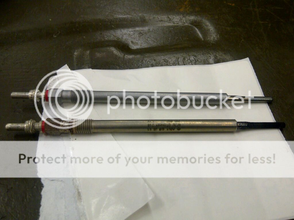

The stock glow plug had the older BERU number on it and there was a noticeable mark near the tip that looked similar to an arc burn but not as damaging.
