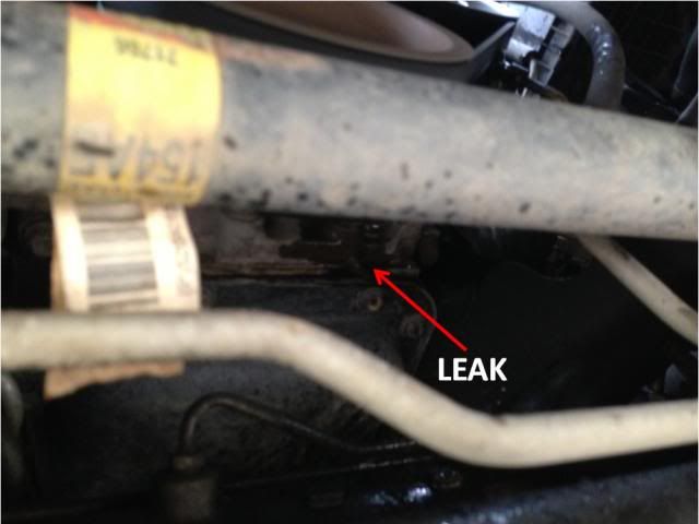

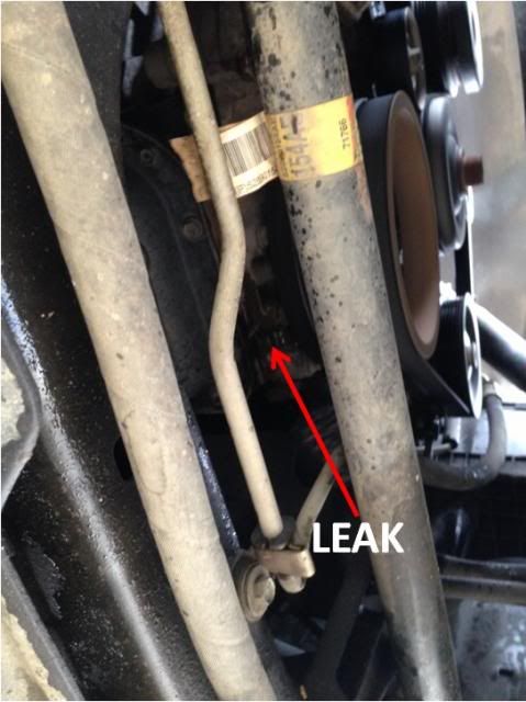

So I got the Commander up on some ramps today and I think I found where the leak is. I took two pics in case I can't describe where the leak is coming from. Basically it looks to be leaking bad right behind the large center belt pulley to the right of the lower radiator hose. I noticed it didn't really leak until the engine got warm, then it was pouring out. Is this the water pump?

most likely water pump, but could also be the lower coolant housing that the thermostat. Both of these parts are relatively cheap so I would suggest you change them both out while you have the coolant system drained out.
As previously mentionned your overheating is likely due to air in the cooling system. Order a new pump and change out the thermostat. Both will come with new gaskets/o-rings.

that's the weep hole leaking, means the water pump is about to go out

My 05 did the same thing. Just found the problem it was a bad thermostat o-ring. The leak was in the same place
