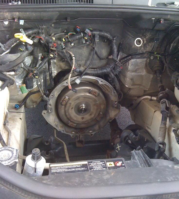

I would agree, i learned this one the hard way....

DAMN!... i know that hurt.....
Thats almost as good as mine......But mine didn;t happen from water... i was abusing 88hp rated rods with almost 500 flywheel hp....

Man that is bad! My block was still good somehow so i guess i was lucky! I live right in the middle of downtown Dallas. I'm trying not to pester the shop too much, but i'm really hoping to have it done by the end of this month. They've had it since August 7th, so i'm impatiently waiting! They plan to dyno it at AutoScope in Dallas as they have an AWD dyno. I hope it'll be done by mid October!
