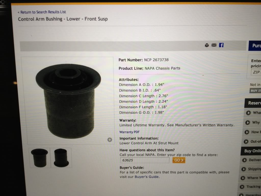

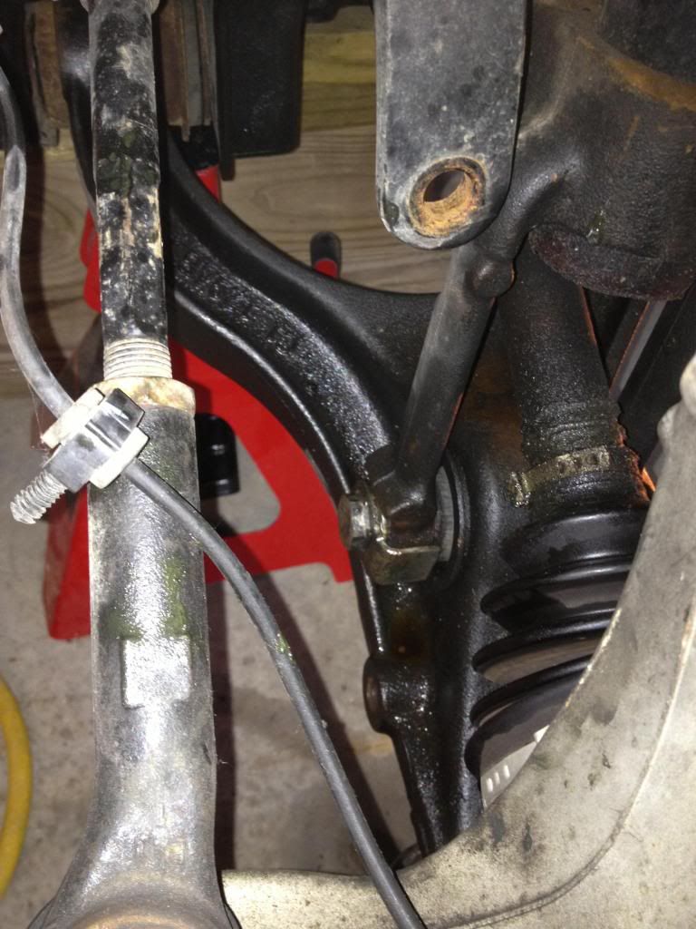

The next morning, we got an early start, anticipating a quick and easy day. Unfortunately this was not to be. Somehow, in all my research I had failed to consider just how stubborn the Grand Cherokee clevis bolt could be. I was further lulled into complacency by the ease of the passenger side removal. Sigh...
Everything went well, right up until it was time to remove that bolt. Stuck doesn't even begin to explain it!!
I looked for help on the forum. Check out the conversation here...
http://www.jeepforum.com/forum/f67/o...-poss-1545300/
Nothing we did worked. No matter how I held my tongue that bolt wasn't coming out! Friday ended in defeat.
Saturday, I woke up determined not to let this thing get the best of me. After working on it for a couple of hours I had had enough. I found this part online:
and decided that I would just cut the bolt. I ran out to the nearest Napa, which was about an hour and ten minute's drive and picked up two bushings. Just. In. Case. I also stopped at a dealership to pick up a couple clevis bolts. They had the bolts in stock but no nuts! (heh) Luckily, dad had a couple that were taken off of our old Ford Excursion when he replaced the suspension on it. Perfect fit!
About six sawzall blades later the deed was done, and with little to no damage to the surrounding metal. We still had to place some washers on the bolt end, then tighten the nut to pull the bolt out of the lower control arm bushing. What an ordeal! Glad to have that job over and finished!

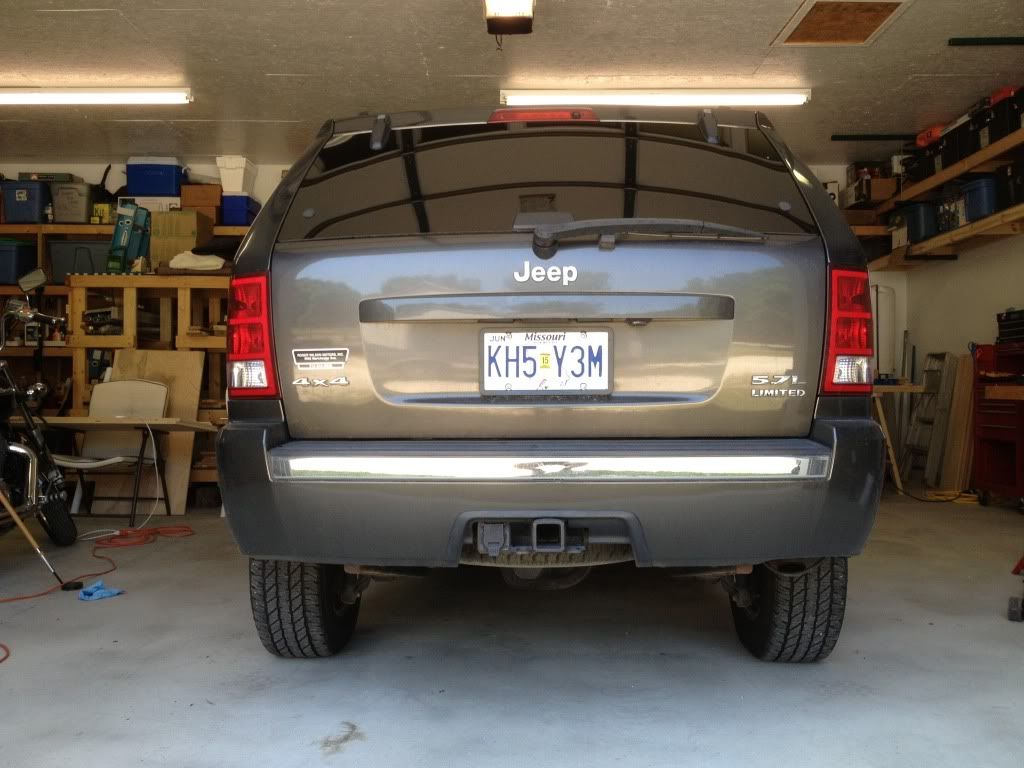

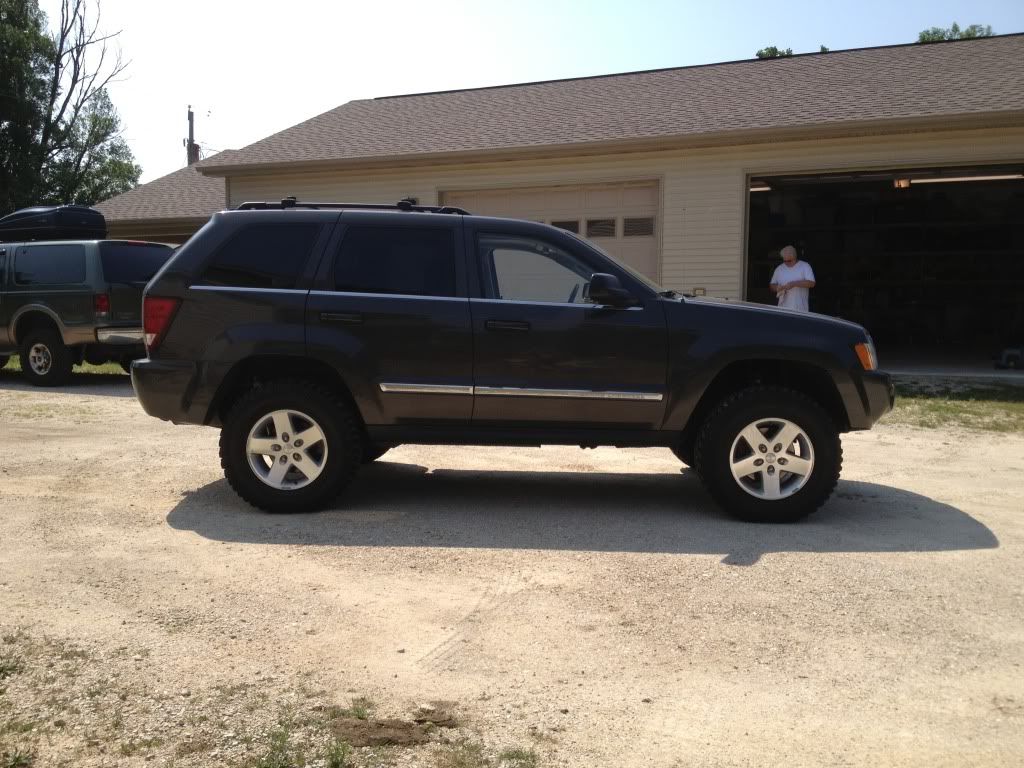

Here are a few shots of the Jeep after finishing the lift install...
Before: bone stock on 245/65/17's (I think)
After: OME HD lift and 255/75/17's
And a few more...
Yep, that's my dad in the background. Couldn't have done it without you!
Finally feel good about removing the front air dam. Looks much better!!
