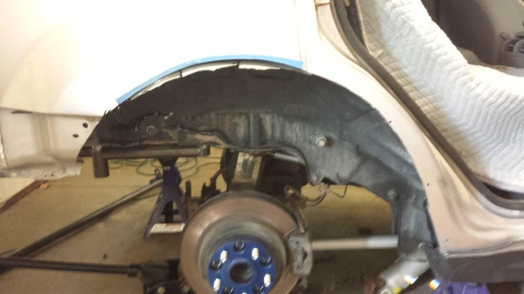

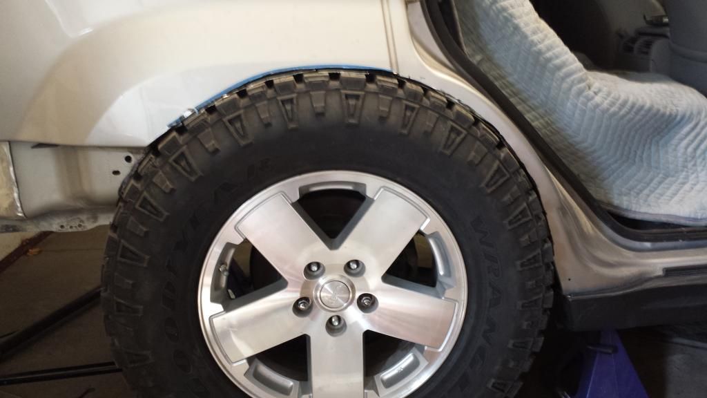

A few updates, I got a little bit of time to rework the rear fenders.
Stock rear fenders and 33+ tires do not fit. Fenders are limiting my up travel.
A little work with a cut off wheel.
Fully stuffing a 275/70/18 tire. Modified bump stops to allow 1.5" of extra up travel. Currently cycling 14-15" of suspension travel with my short arms. I have about a 1/2" of clearance all around the tire to the fender at full bump.
I need to finish welding the inner to outer fenders back together and do some body work to clean them up.

post #132 of 192 Old 09-24-2014, 04:14 AM
caulk04
2008 WK
Join Date: Jan 2013
Location: Greenville
Posts: 2,570
Round wheel arches? Whaaat? It's not a Jeep anymore!
Hah, bravo for being willing to chop up the body, can't say I've seen any WK's yet that are really trimmed for clearance.
08 Limited Hemi - wheels, tires, springs...ya know, stuff
caulk04 is offline
post #133 of 192 Old 09-24-2014, 04:41 AM
paroxysym
2007 WK
Join Date: Jan 2005
Location: Baltimore
Posts: 4,688
this thing should be badass... squatty WK
2007.5 WK Laredo 4.7
OEM+
paroxysym is offline
post #134 of 192 Old 09-24-2014, 06:42 AM
Hendrix9
2007 WK
Location: Beacon Falls, CT
Posts: 821
Will the door have to get trimmed too? I can't really tell from those pictures. This thing is gonna be sick.
I also applaud your willingness to cut up the body. I'm not sure I've got it in me to do that. Haha.
2007 CRD QDII
2010 Jetta Sportwagen TDI 6MT - hoping it gets bought back!
2004 QD 4.7 GC
2009 Rav4 v6
Hendrix9 is offline
post #135 of 192 Old 09-24-2014, 07:29 AM Thread Starter
tnadanzig
tnadanzig's Avatar
2007 WK
Location: Iowa City
Posts: 600
I don't know if I have enough body to make them square. Plus I am not a huge fan of all the open space at the corners of the wheel arch. I added a bit more clearance around the rear arch, but I do not want to totally chop up the door.
Thanks, you can thank my wife for giving me the strength to cut up the body, with her own sheet metal work.
Thanks, I hope it looks low and mean.
The door had to be cut as well, mainly the rear corner. Luckily its not that much so the door should still look pretty stock. Thanks, I hope it performs as well as in my mind. If it wasn't for the previous sheet metal damage I would of been a lot more hesitant to cut it up, but personally I'd rather cut up the sheet metal than put on a lift kit to clear the tires.
