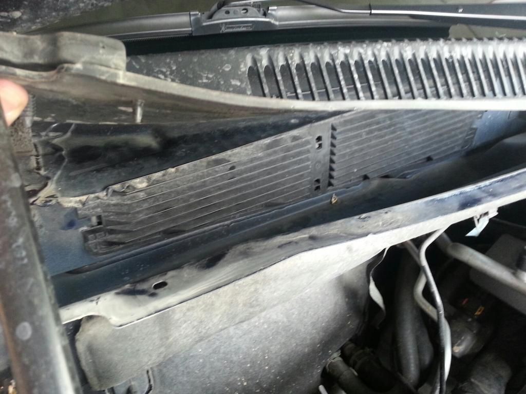

So I just bought the filter yesterday and not the kit. From what I am reading, when I got to install it the factory cabin air filter isnt going to come apart and let me slip the new one in the same bracket? I am going to guess mine hasnt ever been changed before and will still have the factory air filter in it. How much is the kit and can you buy it by itself?

If you have never had the kit installed you will need the kit, the kit comes with the mounting bracket that is required and a filter. After you install the kit you can just replace the filter going forward.

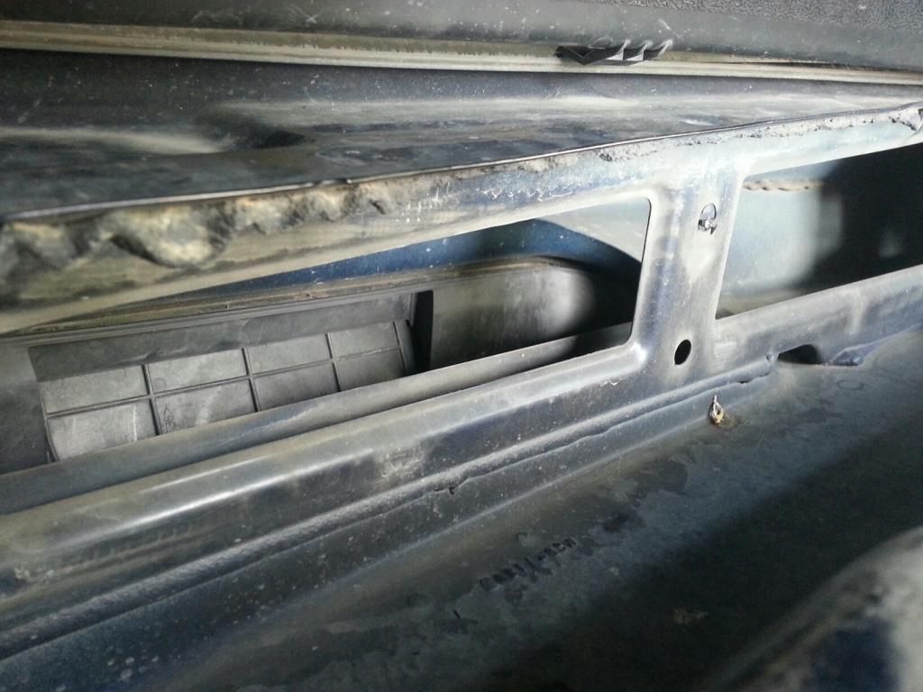

No grand cherokee came with the kit from the factory as I understand it. It's always had to be an add on after the fact. Bought from the dealer, etc. If you bought the filter, you will definitely need the bracket/kit to mount it in there. Right now there is probably only a plastic screen. You can see it, if you look between the slats on the passenger side of your windshield wiper cowling. I'd go ahead and return the filter you bought, and buy the kit from filterheads.com. You'd be saving yourself 15-20 bucks by doing it that way. Here's a link: http://www.filterheads.com/product/single/AQ1097KIT

Unless you or someone else installed a cabin filter in your vehicle, you won't find one. They don't come from the factory with a filter. Filterheads.com around $28. for the kit w/ filter.

Thanks for the input guys. I guess tonight I need to open her up and see if someone else did the didrty work once before.

If you've already bought the filter you can hang onto it for your next filter change. But to use any filter you will need the housing first. I bought filter+housing from the dealer for $50, if memory serves. I called NAPA first and they had the filters but not the housing.

OK so mine came in the mail today and I went out to the jeep to see how it installed and its missing all together.. hmmm.. Some one stole it or took the old one out and never replaced it.. I need to buy just the kit. Where can you get the kit without the filter?
