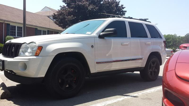

Here is a pic of the WK and my WS6, this was when I was changing all fluids on the jeep, It allowed me to teach my wife a bit and set a new maintenance schedule for it.

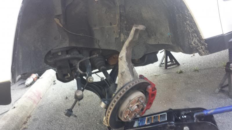

Alright, well this last Tuesday big brown delivered my RC 2" BB spacers and I got them installed that night. It took me about 6 hours doing the install with a bit of messing around and stopping after pulling off the front D/S coil over to head to autozone to pick up a spring/strut compressor. It is not required but I highly recommend it for anyone doing this install. I also have an electric impact so that helped to minimize time and muscle. It was not very difficult IMO.
get it all out
put the spacers on
reinstall
that rear is super easy. It took me about one hour total, that includes jacking it up, removing the tires, unbolting, installing and reconnecting everything. I also did not notch the fuel skid because I had the compressors.
here is a picture of the stock height before the install
and here is the next day after it had time to allow the struts to settle after some driving, plus day light
