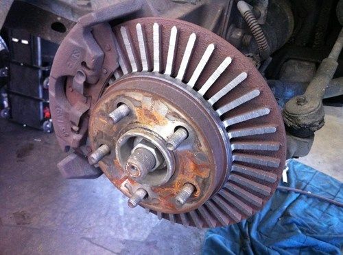

So today the squealing is back with a vengeance. After taking the calipers, pads, and rotors off, and reinstalling, there was little change. The pads are practically new so I don't want to throw them away. I guess my last ditch effort is going to have to be new rotors. I could probably get the ones I have resurfaces, as they are pretty meaty. Thanks for all the input.

I won't be doing any towing - so I may go with ceramics. I used the disc brake quiet on all the pads. It definitely helped - somewhat, but the squealing is still there. One interesting thing I ran into. When pulling the rear brake pads, the passanger side rear inner pad did not have a clip attached to the pad (that is held in the piston). It looks like it broke off, but if it had broke, the clip should have still be stuck inside of the piston. Well, it wasn't. I have no idea who put those pads on, but im wondering if that isn't causing a ton of vibration. The parts store was closed yesterday when I pulled them, so I just put it back on. I'm not worried about braking, etc. becasue the caliper and the brackets hold the pads fine, but maybe that is causing excessive vibration?
