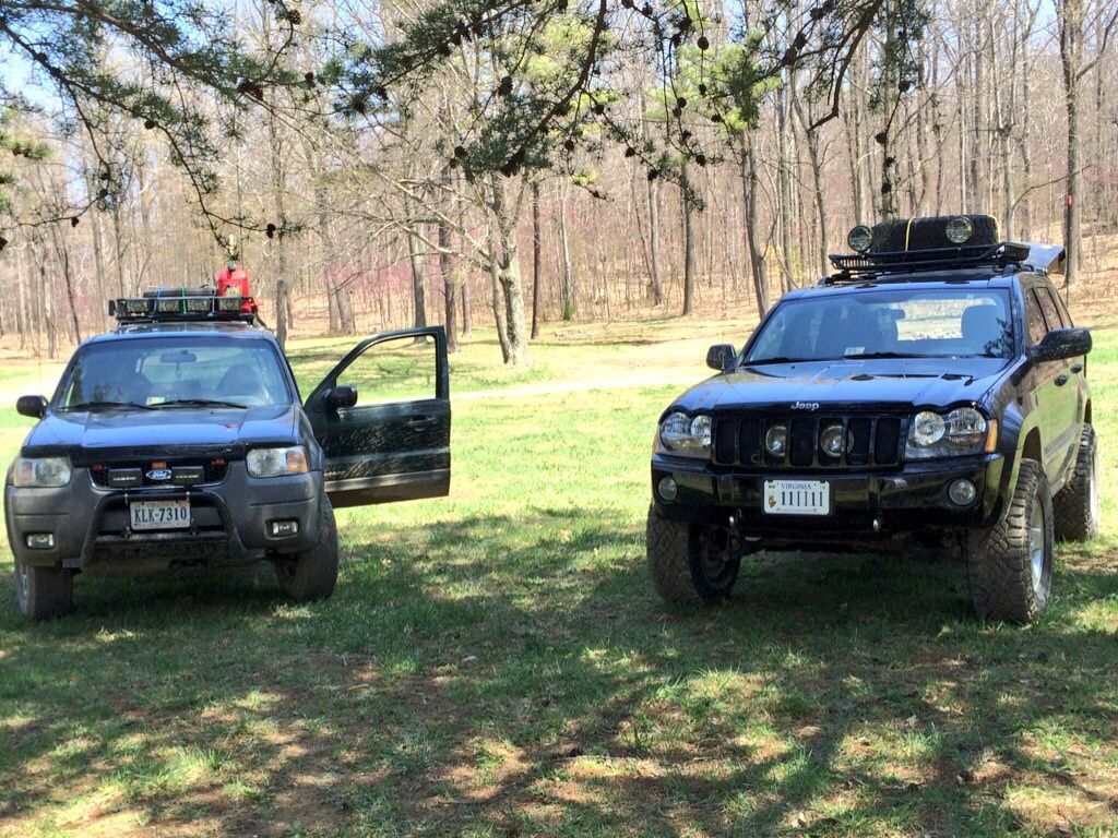

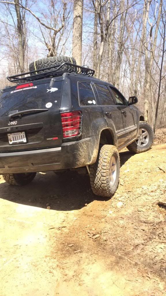

So I fixed the popping noise from the track bar...and today my friend rear ended me, but the damage is right around where a hitch would be, so I'm going to cut out my bumper and install a hitch instead of fixing the bumper.
Pretty good day offroading and shooting guns (spring break at my high school).
