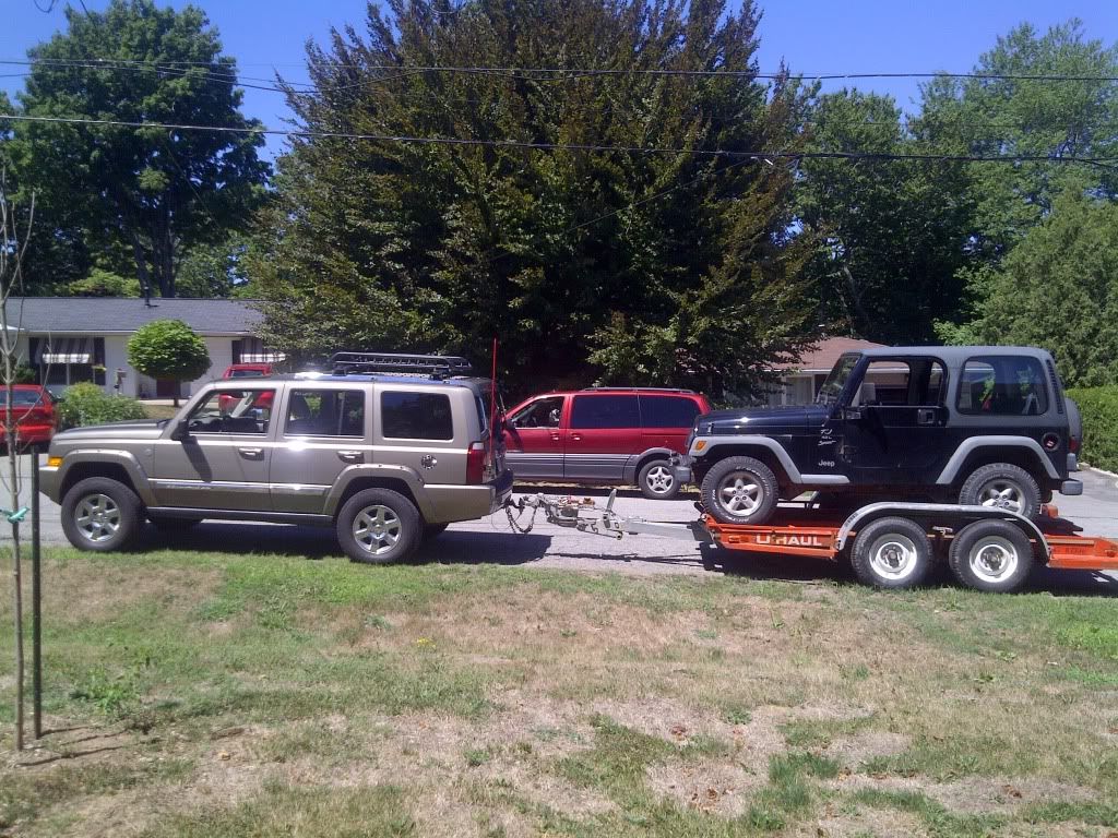

I towed this with my 4.7(stock). Hardly could tell it was back there. 22 ft trailer and Apx 3000 pounds
Lol that trailers overkill for that 4 wheeler

Lol we have four of them. Don't have a small trailer so this is what I used.
