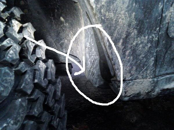

I do know with a lift 3.5RK and 1.5" spacers they rub the pinch weld if you don't take care of it. Pretty bad rubbing too. I think the spacers are what cause that though, so you end up choosing between cutting your balljoint bolt (no spacers) or folding the pinch welds (spacers).
I also like the more aggressive stance the spacers provide. If you do get spacers, you will want them front and back.

My tires only rub on the back of the fender on the plastic liner. That is only due to the diameter of the tire. The spacers are used to keep the tire from rubbing on the upper ball joint stud (the bolt). Without the lift the tires would smack the inside of your fenders every time you hit a significant bump. I paid $98 a tire back in june, they should be $59 on tire rack now. Remember these are the DT tread pattern, the OE tires for the wrangler rubicon, as they are the only siped ones.
