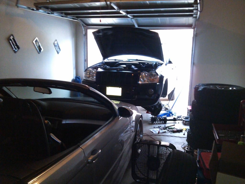

I spent the whole day yesterday wrenching and I'm exhausted! Not having airtools and just working in my apartment garage sucks.
Anyway, I got the 2" lift installed in the front, spacers all around, wheels installed, front air dam removed...... but was too tired to get the rear part of the lift installed.
Still wanted to take it out and see how she drove/looked. Liking it so far.
