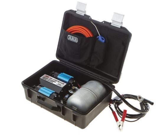

This kit claims:
ē Rapid Inflation of small, medium, large, and over-sized tires
ē Air tools rated up to 174LPM (6.16CFM) continuous supply

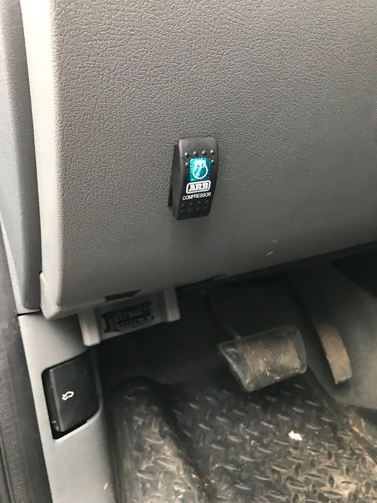

I bought the portable kit because it came very complete and compact, even though the plan was to permanently mount it on the jeep. If I had it to do over, I would probably buy two of the single compressor kits just to get complete redundancy (meaning no single component could leave me without air). I would also look at the kit made for install, because the portable kit has a power draining light bulb in the switch (it gets warm), and I keep hitting the switch with my knee by accident and that turns on a cooling fan too quiet to hear with the hood shut. . There is a connector you can unplug to disable the switch light.

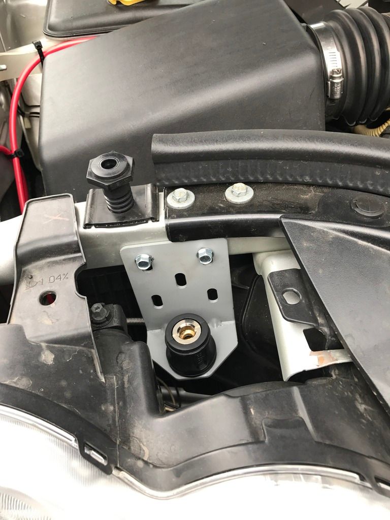

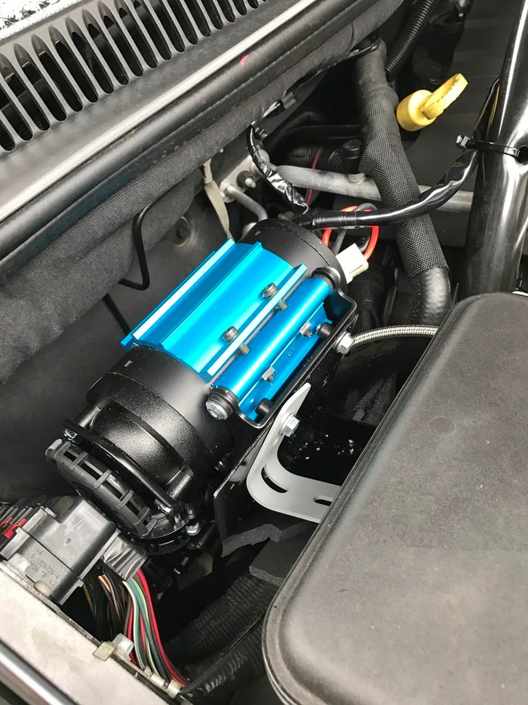

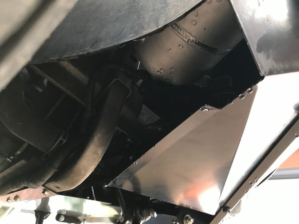

I ended up cutting the control power wire to the switch and installing a relay off an accessory circuit, so the compressors wonít work without the key on. If you ask, I can tell you a good spot to find accessory power to run any relay you wantI have the compressors mounted by the firewall on the passenger side, the tank mounted in a void in the ARB bumper, the air chuck is mounted next to the headlight, and the switch is on the knee panel by the driverís left knee (not a good spot, but easy to get to the inside). I mounted the solenoid behind there, and got accessory power from the fuse block up under the driverís dash.

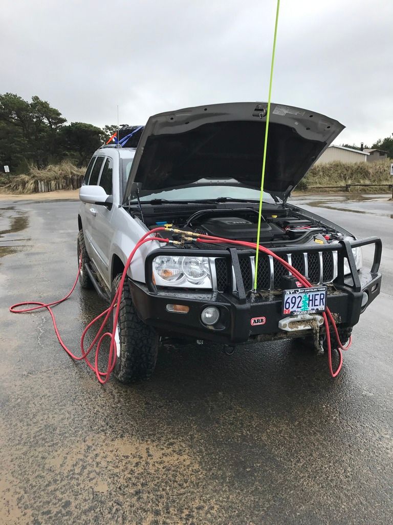

Iíve tested this out airing up from 10psi to 35psi on 33X10Ē tires, and it is definitely fast, in fact I didnít have time to pee before it aired up all four. Okay, I could have if I knew I had to rush, but my plan was to hook up all 4 tires to the regulator manifold, then go use the restroom at the sand lake parking lot (I was right out front). By the time I connected all four, which was quick, and walked around to see that the tires were all inflating, they were already looking streetable (as opposed to flat) so I checked pressure on the regulator and in a couple more minutes the regulator popped off, then the compressors shut off (at whatever pressure theyíre set to).
I timed it in the driveway as a test, with the engine off to see if it killed the battery, and it filled all 4 tires from 10 to 35psi in 8 minutes. It didnít kill the battery, but you can hear it running slower when the engine is off. I forgot to time it with the engine running, but Iíd guess it was about 5 minutes. It seemed quicker than that, but I didnít time it. Maybe next time. Itís worth mentioning Iím running a group 49 AGM battery, which is almost 2 stock batteries, so donít assume you wonít kill your battery if the engine is off.
