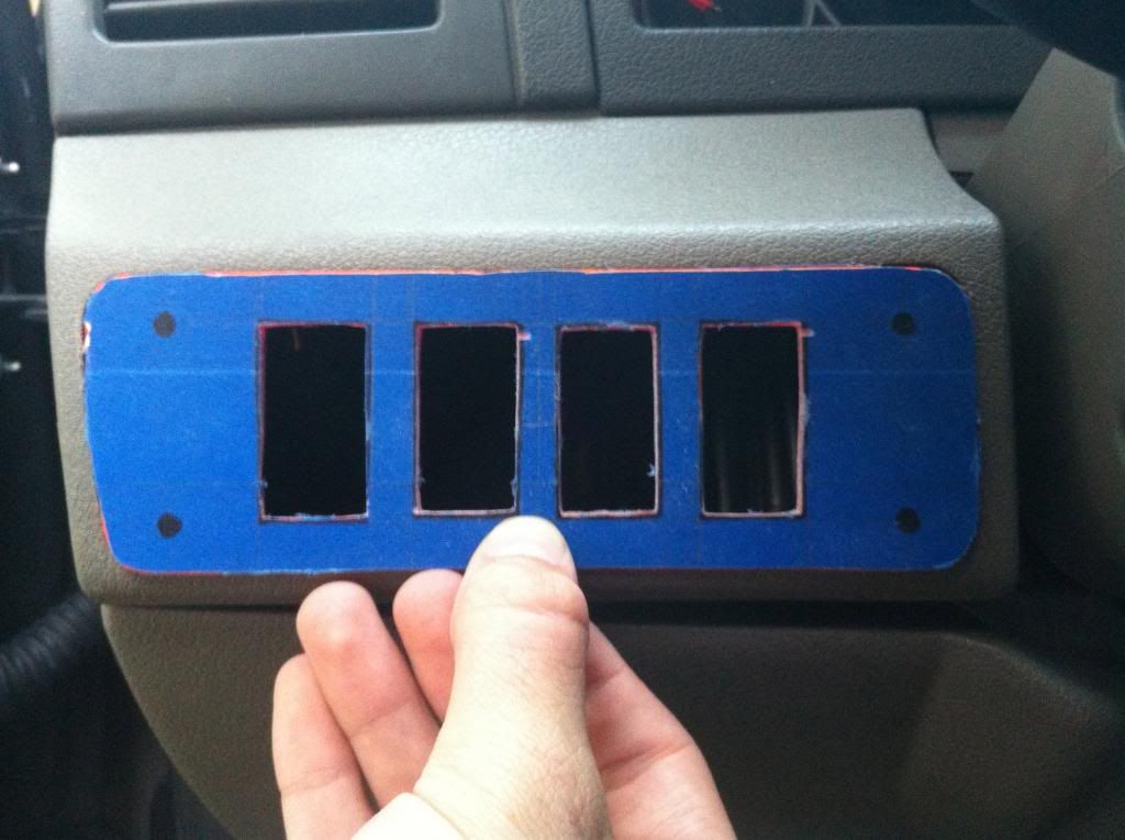

I have been meaning to show how I did my roof lights for awhile now. I guess this is a good time as ever!!

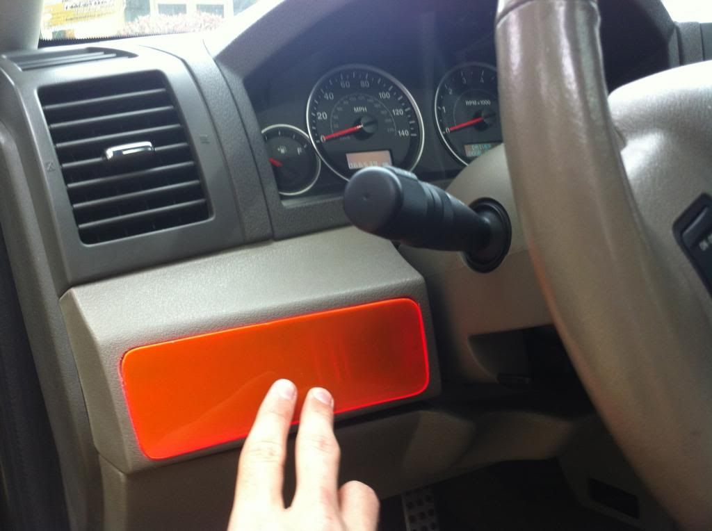

I first needed a switch panel! I wanted something semi custom. I knew Saquaro (Aspen Creek) had been making a 5 panel for the cubby hole, but I figured I could make one cheaper. I grabbed some scrap plexi I had laying around and got to work!
First I removed the cubby panel, and traced a template for the hole. I then used this to cut out a piece of plexi to fit:
I then had to figure out how I was gonna mount it. I decided to use a couple of scrap pieces as back plates. (I don't have any pictures of them) But I used 2 bolts on each side to essentially wedge the front plate and back plates together. This is very similar to what saguaro does with their design.

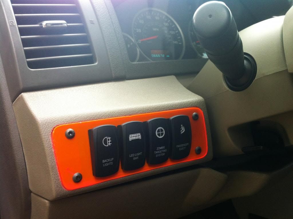

Once I had a way to mount it, I figured out the placement/spacing of the switches so they would interfere with the back plates. I decided to only go with 4 switches at the time. I really didn't see the need for 5. I cut the switch holes out with a router drywall/plastic cutting bit.
In this pic you can see one of the back pieces if you look at the 4th switch hole:
Next, I mounted the switches on the switch panel, and wired them according to Nate (Omelet's) guide in his build thread.
Then tested to see if the lights on the switches were working properly

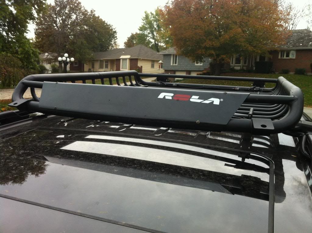

Now onto the LYTESSS!!!!

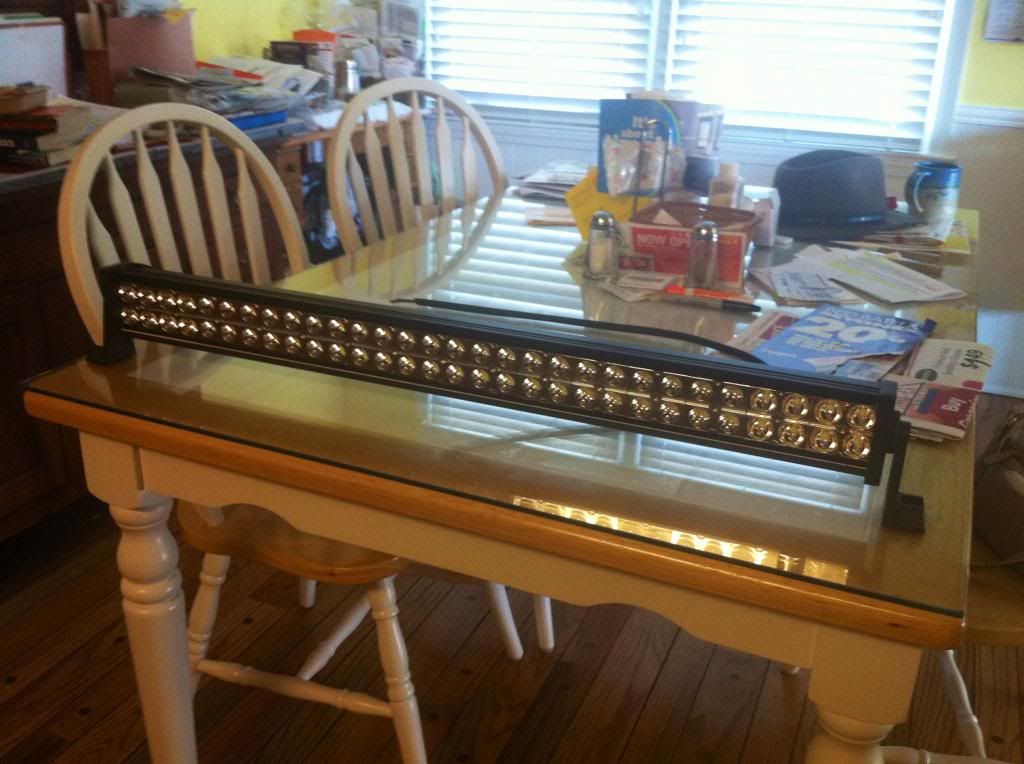

I bought a 32" tough light for my Rola Rack during a group buy. For the money, I couldn't pass it up, and they made it custom to my needs. I did a combo light bar with floods on the outside and spots in the middle. 12,500 lumens of AWESOME! The quality has been great, and it has stood up to everything I've put it through. You can go to their website Tough-Light.com and you will see my rig in their product photos!
I mounted it using 1.5" PIAA light mounts I bought off clearance from 4wheelparts.com for $20 bucks per pair. They were originally silver in color and I bed lined them black to match the Rola. You can get the same mounts but in black off eBay for $20 + shipping.
I measured out where I wanted my light bar on the front and installed the mounts. I used red locktite on the bolts to make them harder to steal.

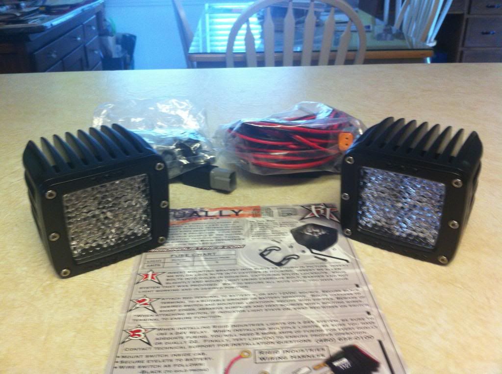

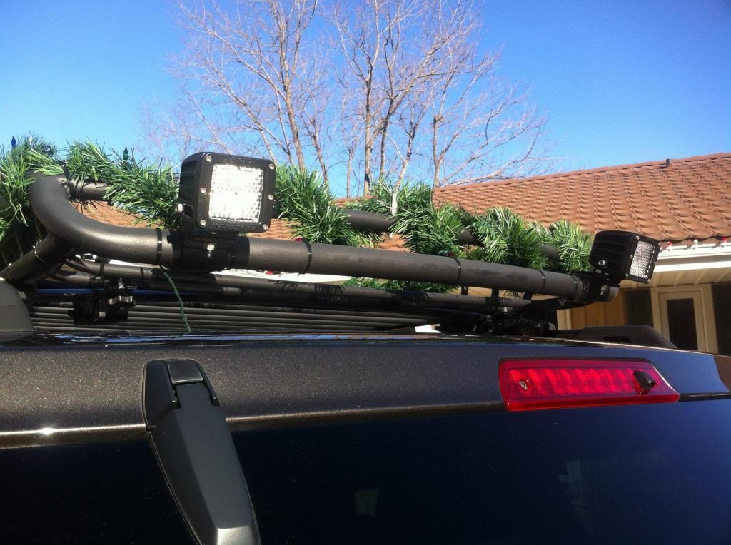

Next came the back up lights! I bought some display model rigid dually's with diffused licenses from a friend's 4x4 shop.
He gave me a deal I just couldn't pass up!!
I decided to test them out in the garage before installing
Once I knew they were working, I mounted them up on the Rola with the same PIAA mounts I used for the light bar.

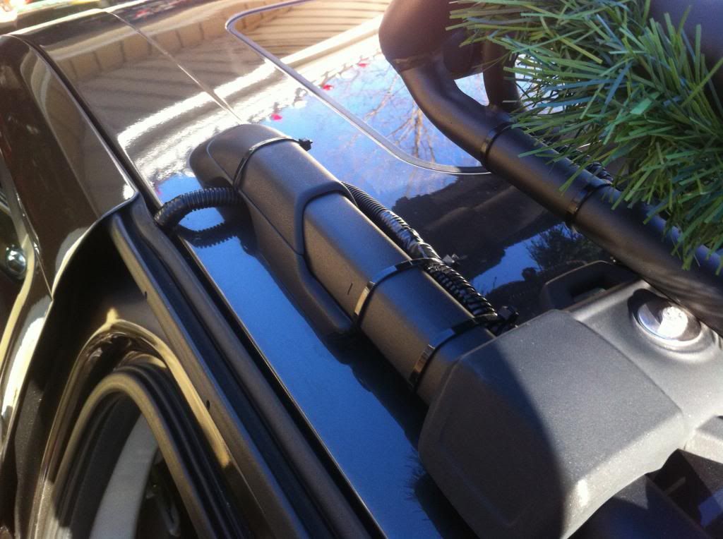

Finding where I wanted to run the wiring was a bit tricky. I knew I wanted to keep it as hidden as possible, but didn't know how. I looked through some other people's build threads. But didn't come up with any good results at the time. So I started looking around and found that you can run the wiring down the top weather strip for the doors. It runs all the way from the tops of the doors down to the front of the doors near the engine compartment. You simply pull it off and hide the wires behind it in the channels available. I ran 2 sets of wires down the driver's side this way.
I started at the back and worked towards the front. I neatly ran the wiring harness for the rigid's and zip tied it to the Rola.
After that was done, I ran it down the side of the Rola and the roof rail to the weather stripping above the doors. I sealed all my wiring and connections with tape and split loom tubing to keep it sealed and hidden.
On the front light bar, I zip tied my wiring to the Rola and ran it over to the driver's side through the front hole in the roof rail above the drivers door. This spot kept it hidden, and I was able to zip tie it out of the way far enough not to be seen. You literally have to be looking for my wiring, or you will not see it!!

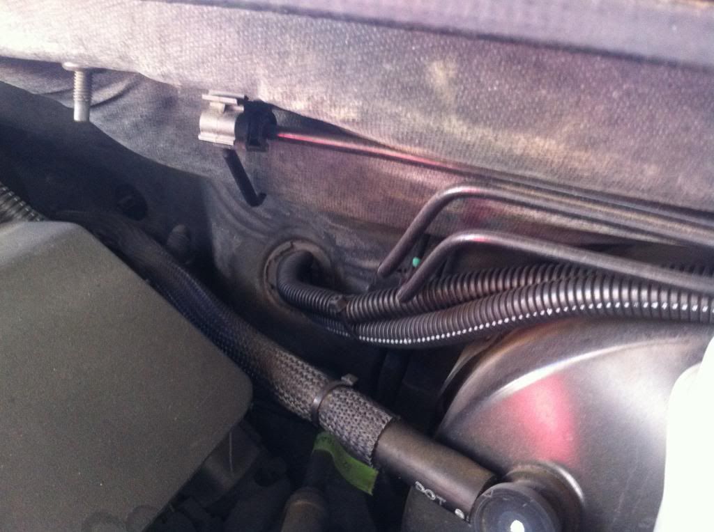

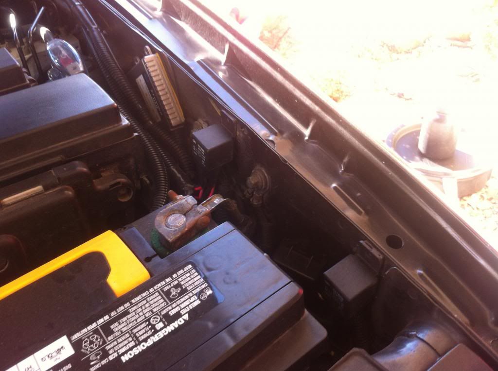

Once I had the wiring ran up top, I ran it down towards the engine compartment. I covered it with some heat shrink tubing, and snaked it around the door and hood hinges to the engine bay. (Its easiest to push it under the windshield wiper cowl, that way it doesn't affect the hood hinge). I have high-lighted the wiring with a yellow circle. It was kind of hard to see in the pic without it.
Here's where the wiring came out in the corner of the engine bay:
I ran the wiring down towards the front by the battery tray where I have all my relays, and other wiring harnesses for my HID's, and stereo. This seemed like the perfect spot for grounding and sorting out which wires needed to go to the battery and which needed to go inside the jeep. It also made for a cleaner look overall since I did not have enough room for a all in one fuse box like some have done. I may decide to add one later on when I add MOAR LYTESS!!!
I ran the wiring in through the firewall using a grommet that wasn't being used.
This seems to be the popular spot and allows for easy wiring up under the dash area.
Once I had the wires ran into the dash area, I connected them up to my individual switches. And that was pretty much it!
