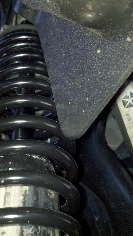

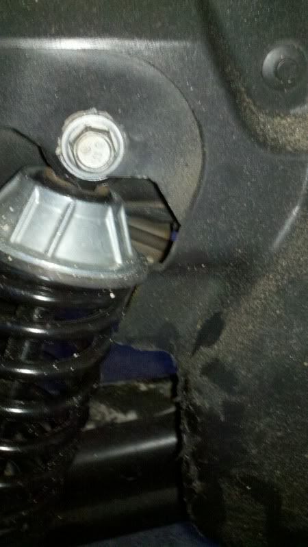

I noticed after my first drive with the new shocks a 'clunking' which I kinda knew what it would be but I wanted to see what it would do. I don't know if the XK's have this problem. But some of the wheel well plastic gets awfully close to the shocks. Anyway, anytime I went down a dip, where the shocks have to respond quickly - The plastic would actually have noticeable contact with the coilovers. So I had to trim this down. I ran out of Daylight to tighty this one up, but I'll get to it tomorrow... Oh I will!
The Issue:
As you can clearly tell, plastic is too close. And yes, I can see that rubber boot slowly making it's way down the shock - I'll have to consult Sal with that one - because I'm not pulling that side shock off, lol. Was a PITA
Solution!
Dremmel Tool, extension cord, power inverter
Nearly done
As I said, I ran out of daylight, but I plan to tighten up the 'finish' so that it looks a little more professional.

Did cutting back the rear fender well liner solve your dilemma?

Yeah - that resolved the issues - It's been quiet as a mouse back there, but I expect a new sound to start turning over soon - the rubber sleeve protecting the shock from the coil is slowly but surely making it's way down the shock. So, I'll have to take care of that soon too. I'll have to work with Sal on that one though.
