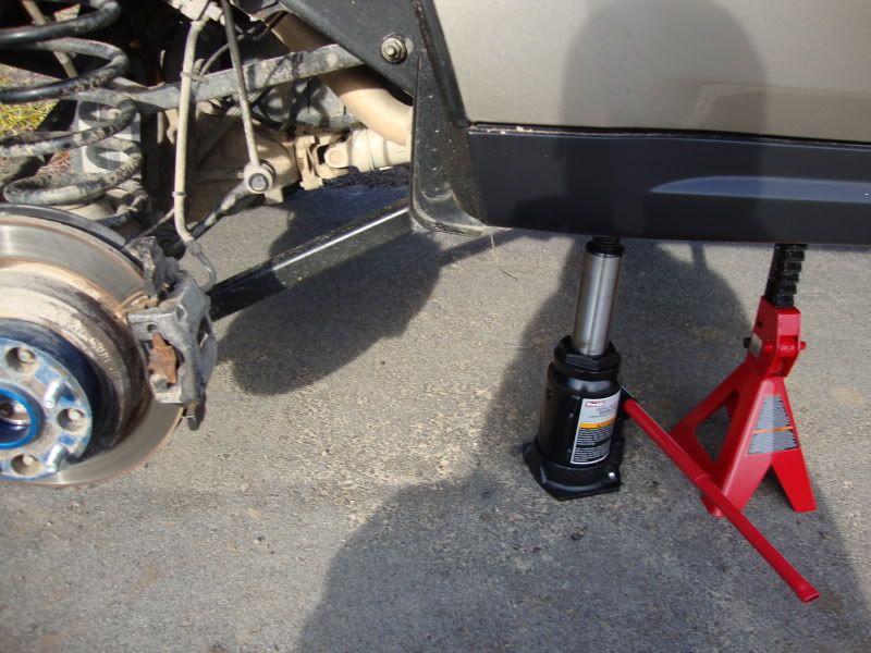

Today my MLL+'s ( extended Monroe Load Levelers) arrived. Additional hardware was necessary to make sure they install correctly - they are actually made for the Ford F150. I used two washers at the top mounting locations to prevent any play in the mounting location. Installation was fairly easy.
I was trying to use a second jack I had to compress the shock into the slot - but I kept getting contact with the chassis which didn't help. After Sal laughed at me enough, I finally decided to try his method. It took me all but 5 minutes to get the passenger side in. Driver side took slightly longer due to the fuel tank, but I did some funny stuff to get that one in.
I measured 20.7" in the rear with all the skids, and my cargo full of crap pic below
passenger side took no time
tire on
Also finished up the work for my 4xG Ant mount - drill died in the middle of it.
All done
My spare OME shocks.
The ride is a little more firm in the rear - I love it. Cornering is a little better for me as well. Rear measured to be 22.5" from center cap to fender well... VERY pleased with this. Anyone comparing my previous pic's to this will clearly see there is additional room there in the wheel well area. Total yield from these shocks was 1.8" (with all the crap in my cargo).

Just curiosity what was Sal's way? I'm assuming disconnecting the swaybar? I had 2 people, jacked it up as far as I could without disconnecting, put a second jack under the shock, compressed the shock, put a ratchet on it to hold it compressed, slid it in and used 2 screwdrivers to align. It was actually way more complicated than shocks should be in my opinion.
Oh and keep and eye on the rubber sleeves. They'll most likely slide down on you unless you glue them in place. (You probably know, just figured I'd remind you.)
Yeah, Sal recommended me D/C the sway bar, and let the axle drop. Works well on the passenger side, driver side - fuel tank got in the way. On the Passenger side I used a combination of your method and Sal's.
