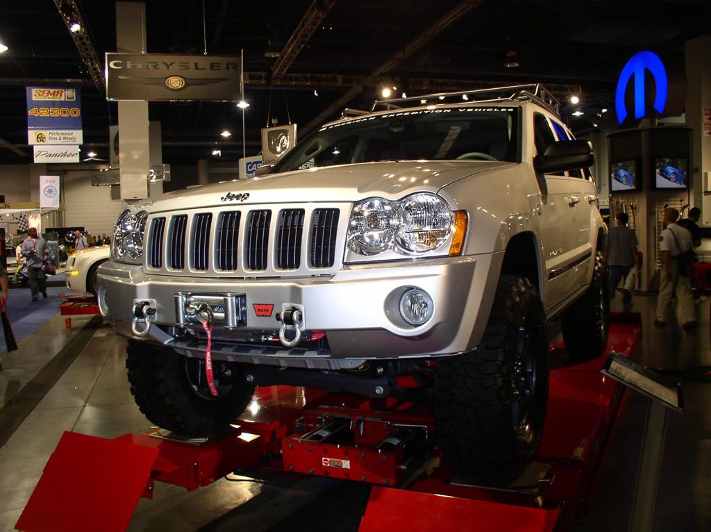

The only WK I know of that had 3/4" spacers was AEV's Mojave.

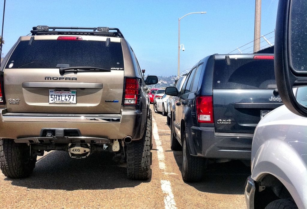

Well I am probably not the best for comparison, but here is a shot with 17" moabs, 1" spacers, and 295/70R17 (33.5) Nitto Trail Grapplers:
And with the same wheels and spacers but 35x12.50R17 BFG KRs (they are a little fatter):
And the Mojave which had the stock 17" wheels, 3/4" spacers, and 305-75-R17 (34") Goodyear MTRs:

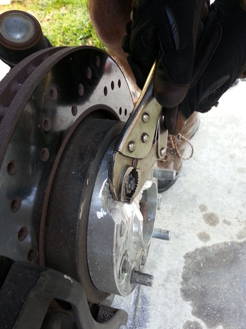

The pockets are pretty deep! Here is a pic, the nuts on the stock lugs are just less than flush, so the little bit that sticks out past the nut is the excess. (the nuts in this pic are slightly loose)
