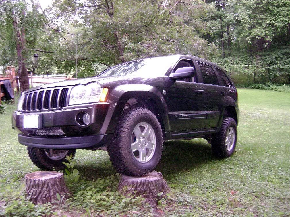

Here's mine with a 2.5" lift:
I recommend a lift with these tires, they would be stuffed in there without one and I'd imagine they would rub every time you'd hit a bump. Hope these help!

Sounds a bit too much without a basic lift.
Also your ESP, Traction and Speedo would not work properly. I am not sure if you can get the system re-calibrated with the new size tyres.....
ESP and traction work fine, until all fours come off the ground over some train tracks
