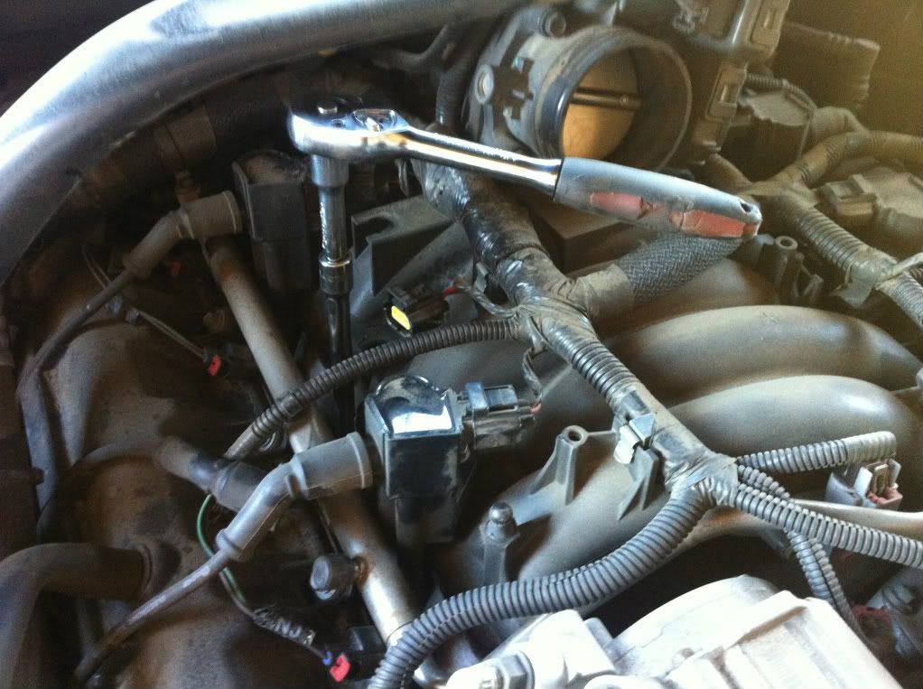

After you remove the air intake tubing and the airbox attached to the throttle body you will see this:

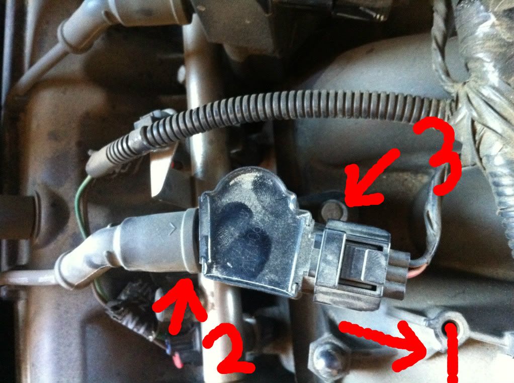

Coil pack:
1. Remove the electrical plug.
2. Remove the Secondary plug wire.
3. Remove the 10mm bolt that holds the coil pack down.

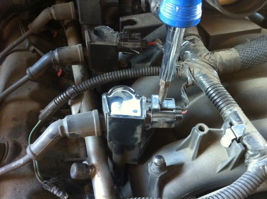

If you push down here with a screwdriver (lightly) and pull the plug it will slide off easliy.
I wiggled and pulled the first coil up slowly. It popped right off with no drama and in one piece!!! Mine had some yellow spark plug boot grease in the boots.
So add a bunch of new spark plug boot grease for the future.
Next you will need a thin wall 5/8" spark plug socket. I got lucky in that the 5/8" that I have is thin enough. It was thin enough for 6 of the 8 cylinder holes. I had to sand it down a bit to get it to fit #8 and #5.

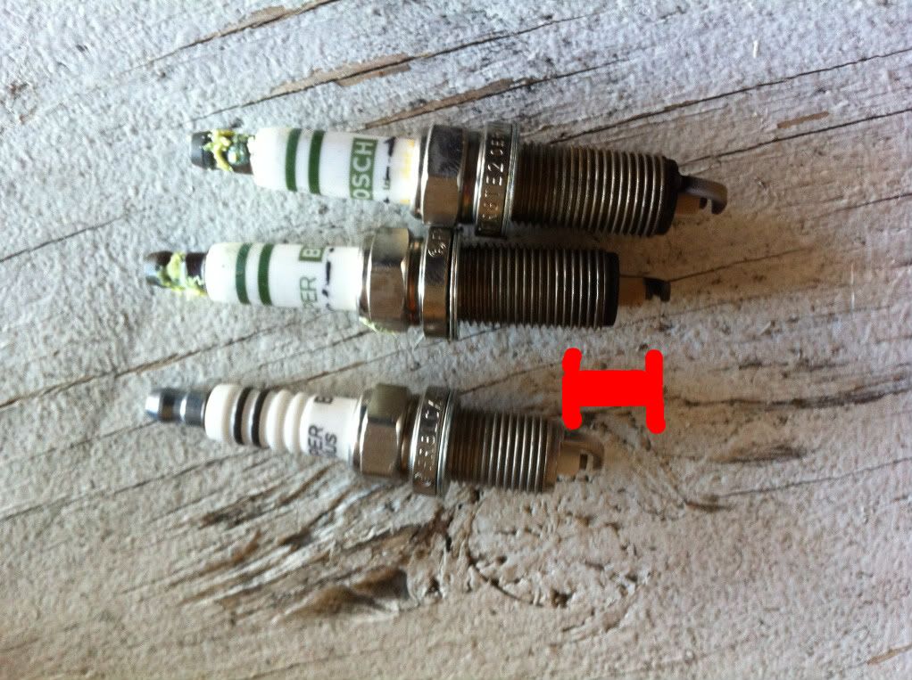

Plugs removed:
Top is the factory FR8TE2
Bottom is Bosch 7962
The old plugs were about .046 gap where the new ones were all right on .040 as spec'd. Not in bad shape though for 51k miles.
Without knowing the combustion chamber profile of the second gen 4.7 we really do not know how shrouded the shorter spark plug is or how far the longer plug sticks into the chamber.

Reinstall in reverse. Plug #8 (furthest rear, passenger side) is a real pain though. Everything under the hood of this thing is sharp and black. so be prepared for some skinned knuckles.

I was just about to do this but have a problem. The first time I did this I used the shorter reach Bosch 7962's. This time I got the FR8TE2 which is correct in the owners manual etc and has the much longer reach (as modernblueWK shows in his picture) than the 7962's. I am sure that the FR8TE2 I bought are not the right plugs for my '08 4.7 V8 FlexFuel but they could be easily be installed by mistake.
I installed one of the FR8TE2 and it does not fully seat in the socket. The top of the plug is visibly higher up than the 7962's and I could see that the top 3/10 inch of threads on the FR8TE2 was not touched (I put some anti-seize on the plug and tightened it down to see). I guess it would be safe to install the plugs because the cylinder head threads would prevent an over-long plug from being installed but the plug would not seat and is clearly too long for this engine.

My mpg's have gone down to 15-16 mpg average. I noticed a slight miss around town and noticed a distinct lack of power on a recent trip over monarch pass.
I decided to buy a set of the proper plugs FR8TE2 from just for jeeps. They came in mopar boxes so I am sure they are the right ones. Spent an hour in the garage, swapped the short bosch plugs out for the mopar plugs.
What a difference!!! Power is back, mpg's are up and the engine runs alot smoother at part throttle around town.
So..... Buy the FR8TE2's they work better.
