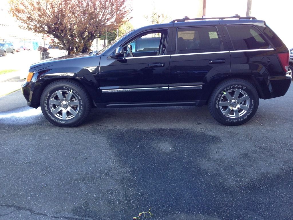

I decided to go the other direction with my wheel/tire set up. The Jeep is on SRT8 springs/Bilsteins WK. it clears the bolt. A little bit of rub on the inside frame. I'm temporarily using 1/8" spacers up front but I think 1/4" inch would work. Just very difficult to find good 1/4" spacers.
[IMG][/IMG]
