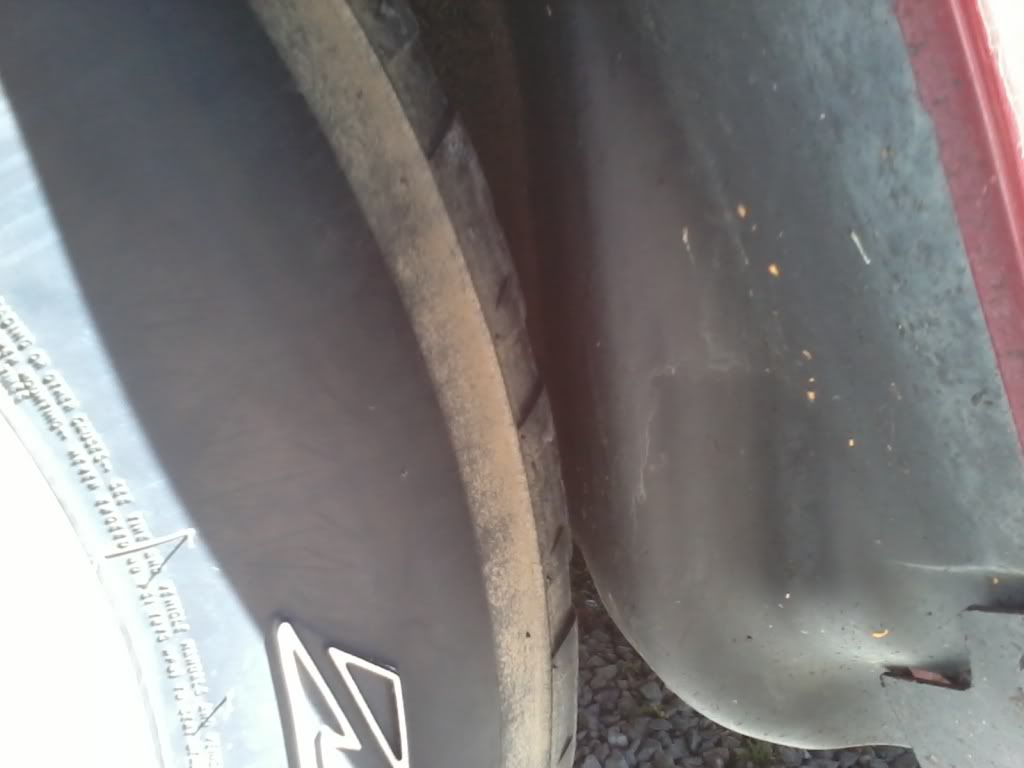

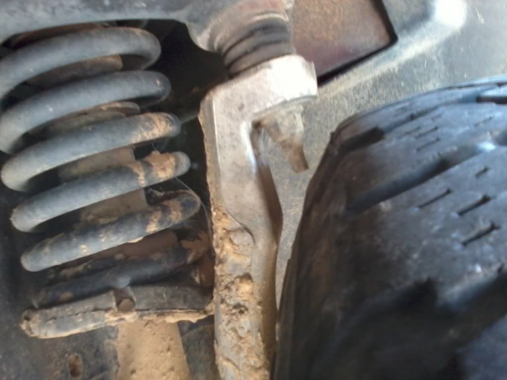

Here is my clearance with 255/70/18 keep in mind they have less than half tread. I will probably need pinch weld if they are any taller and spacer if any wider.

Do you think the higher tread of new tires will still clear the pinch weld? The ball joint bolt clearance should be OK judging by your photo. I may not need to use wheel spacers.
Its pretty close to the pw. New tires may have a slight rub. I can post an actual measurement tomorrow if you want. Only concern for spacers is caliper if your newer than an 06.

I have the same Bridgestones as you, but I am doing a 2" lift and want to use 1.5" wheel spacers as well. From your pics it looks like the tires will fit without the pinch weld mod but if I use the wheel spacers they will probably rub because of the larger turning arc of the front wheel. The lift will make a wheel alignment necessary as it changes the geometry of the caster, camber, toe in etc.
