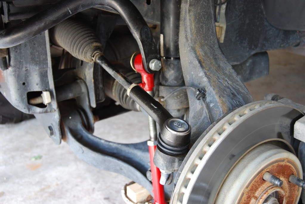

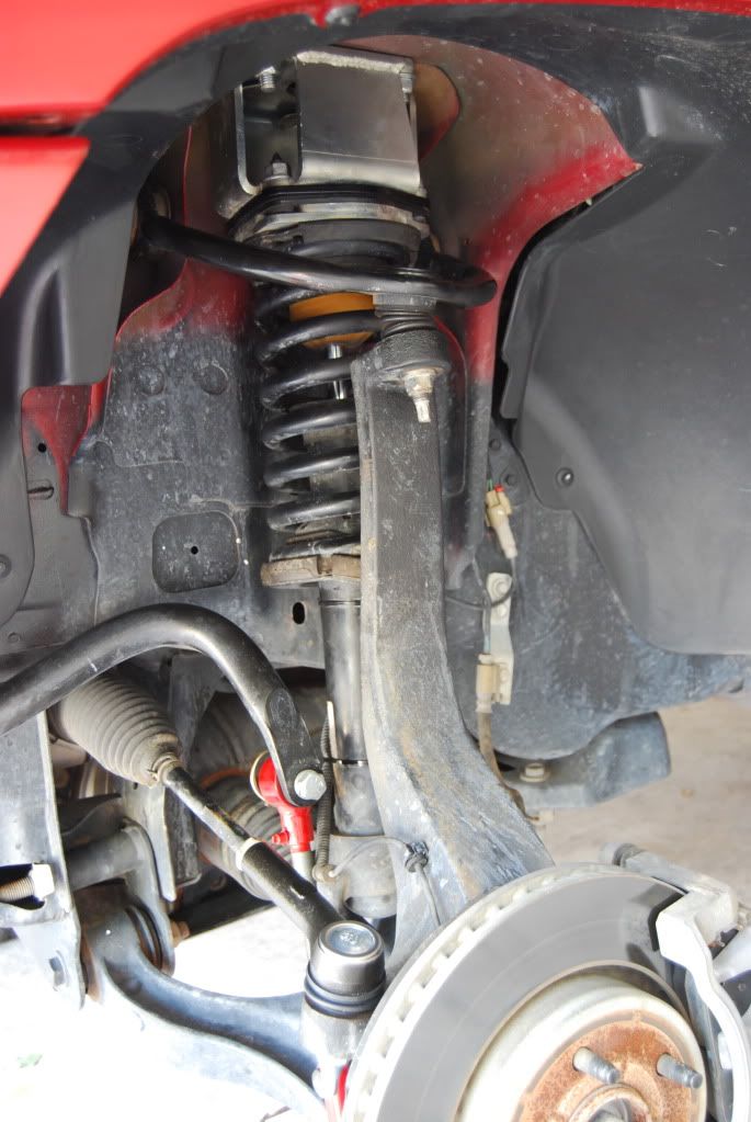

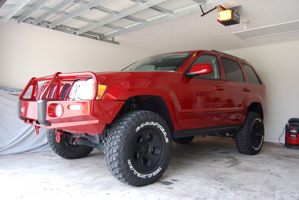

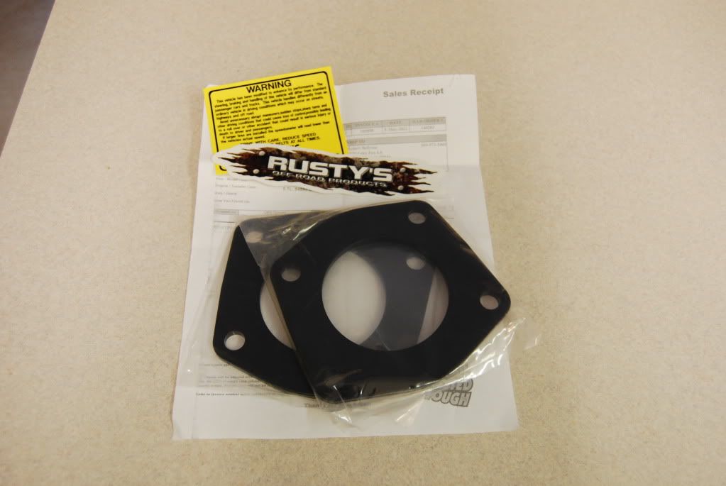

I'm heading to Ouray Co in a little over a month for some 4x4ing (go figure I'm going to be a few days too late for GSW) so I figured I'd best fix the front suspension. The bumper lowered the front suspension about 1/2 an inch. So I purchased some Rustys spacers.
These spacers are really made for those without a spacer already, but they work with the SL spacer *barely*. Any lower and the spacer itself would contact the body right at the spring perch.
I also added some JBA disconnects and replaced the tie-rod end I ruined during the initial lift install.
before the spacer:
after:
The difference is subtle, but I regained the 1/2" as advertised
