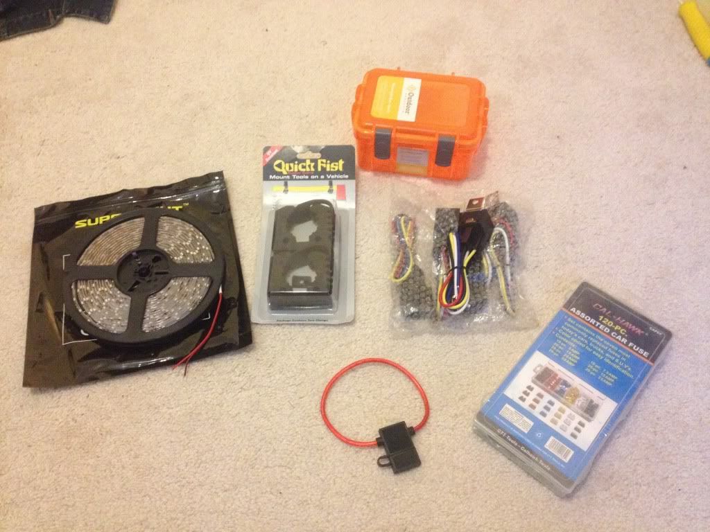

Just got some goodies in the mail today!
LEDs for rock lights and trunk light Mods, Quick Fist clamps to mount an axe and shovel, and electrical goodies to make this:
This DBox should simplify my current Rigid Industries lighting and then make my future Rock Lights and any other electrical wiring a synch!
I also got 4xGuard Rock Rails in the mail today. Let the fun begin!

Where are you going to mount you DBox? Also, can you let me know where I can get her information to work on my Jeep with me?
Haha, for real!
Right now, I'm eyeing the passenger side of the engine compartment against/near the firewall.

For roof lights, would you try to run your grounds from the roof down the windshield with your powers to the DBox or are you going to try to ground up top?
Don't know. Not planning any roof lights as of now, but if I were to, I would imagine I would run the wire down to the engine compartment. I would probably see if others had a picture or eluded to where they grounded, i.e. some build like Omelets.

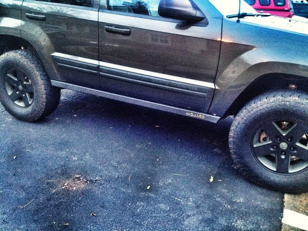

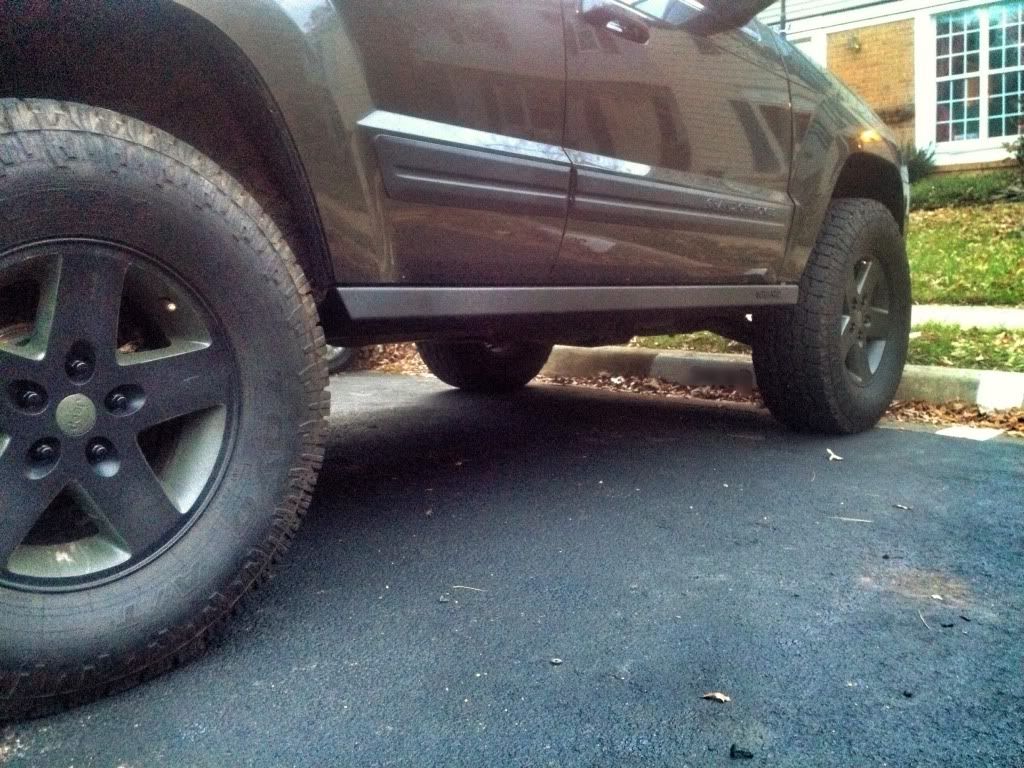

Got my 4xGuard Rock Sliders installed today.
Followed the directions Chirpz put up a while back to the "T". http://www.jeepforum.com/forum/f67/4...-step-1304425/
Took me about 1.5 hours, I used the following tools:
1/4" drive - 5/16 socket
3/8" drive - 9/16 socket
3/4" drill bit
1/16" drill bit
9/16" box wrench
Torque wrench
Awl
Brakleen Brake cleaner (to clean the lower door sils)
Shop Towels
Only trouble I had was on the front passenger side pinch weld. I had smacked it on the trail last year and it needed to me massaged back into place with a small mallet.
