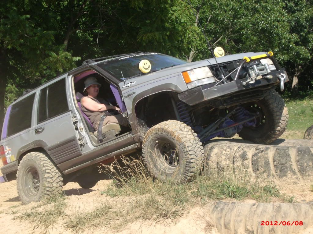

I started with a rough country basic 3.5" lift. Added iro upper arms and 2" fatbobs spacers, then an iro adj track bar in the front. Right now I have procomp steelies 16x7s of 32x10.5s but within the next few weeks it will be rolling on 33x12.50s on alloy wheels 15x8 or 15x10 either with 3.75" backspacing or less
More pics, one from the side...ish and a couple flexing today

Mine measures 23.75" inches from the center of the hub to the fender. 18" is stock so I net about 5.75-6" of lift
