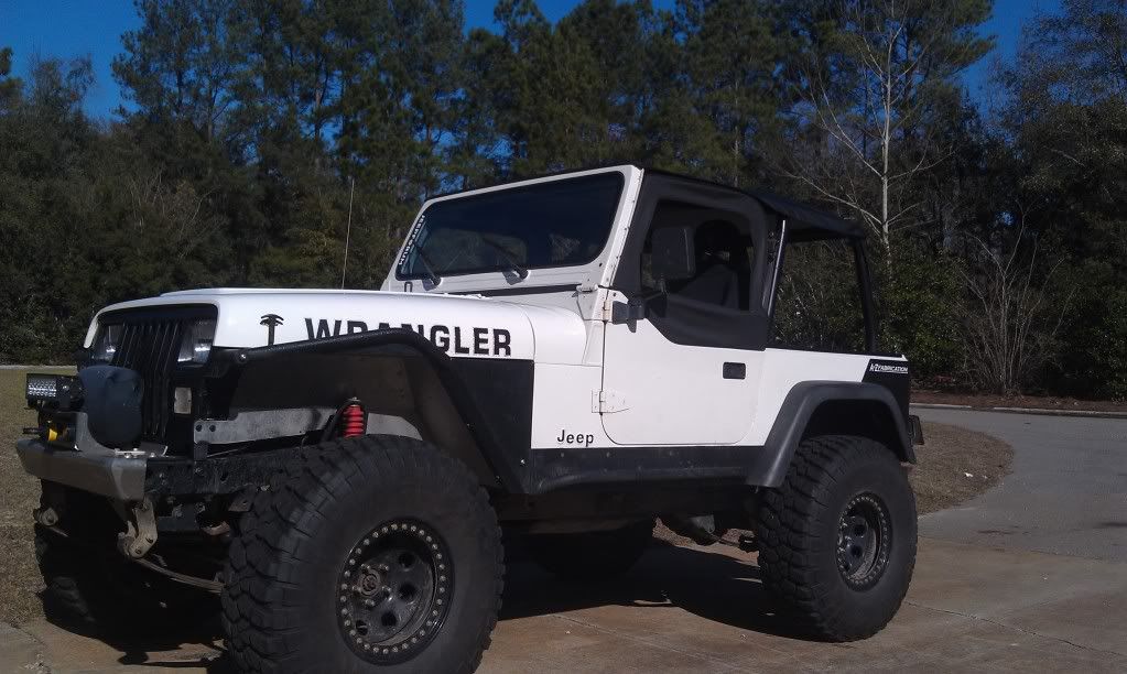

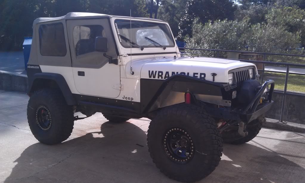

for the past two years i have been runnin my yj on a rustys 4 inch kit which was closer to three inches but i just bought some waggy springs and im getting ready to throw them on but im not sure how it will look that low on 35s. any pics of 2 inche lifts and 35s will be appreciated.

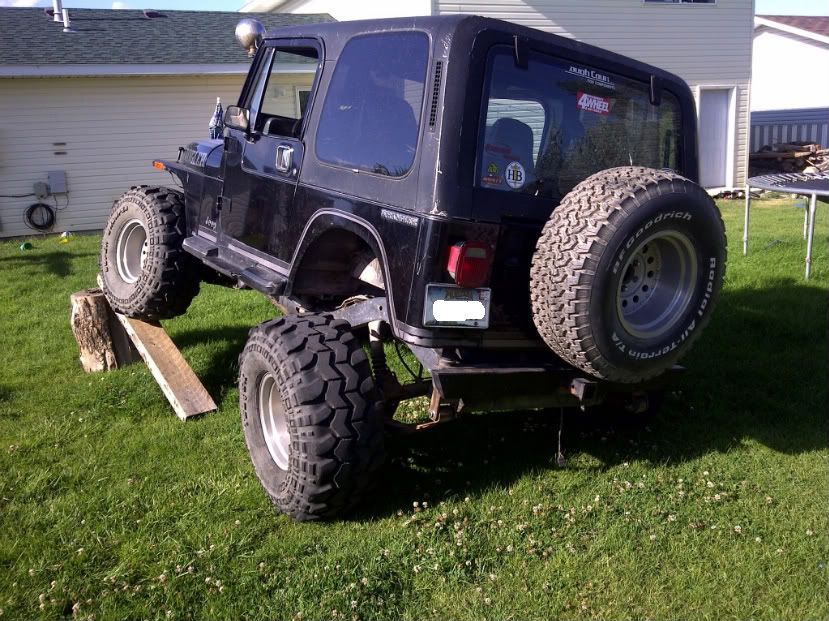

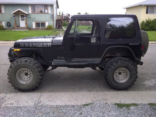

bft89yj I know you have seen pics of my jeep before with Waggys and 35's, and there is plenty of room. If I didnt have a 1" shackle lift and 2" body lift they wouldnt clear very well. It is totally possible you will just have to trim more of the rear than I did. I know I could make it work without the 2" body lift I plan to cut mine down to a 1" real soon. I'd say at the very least go with a 1" shackle and 1" body and you should be fine with some trimming. You shouldnt have any trouble with your metalcloaks. Are you still going to use XJ's for the rear? or waggys all around? Oh it is a picture thread so:

you mind measuring from the ground to your frame for me cause i know mine is right at 19 just to give me some perspective on the height difference.

I'm sitting right at 19" to the bottom of the frame with my 33" BFG's. I currently do not have my 35's on but they measure out to about 34" and my 33's measure out to about 32" so it should be about 21" to the bottom of the frame with the 35's on hope this helps?
