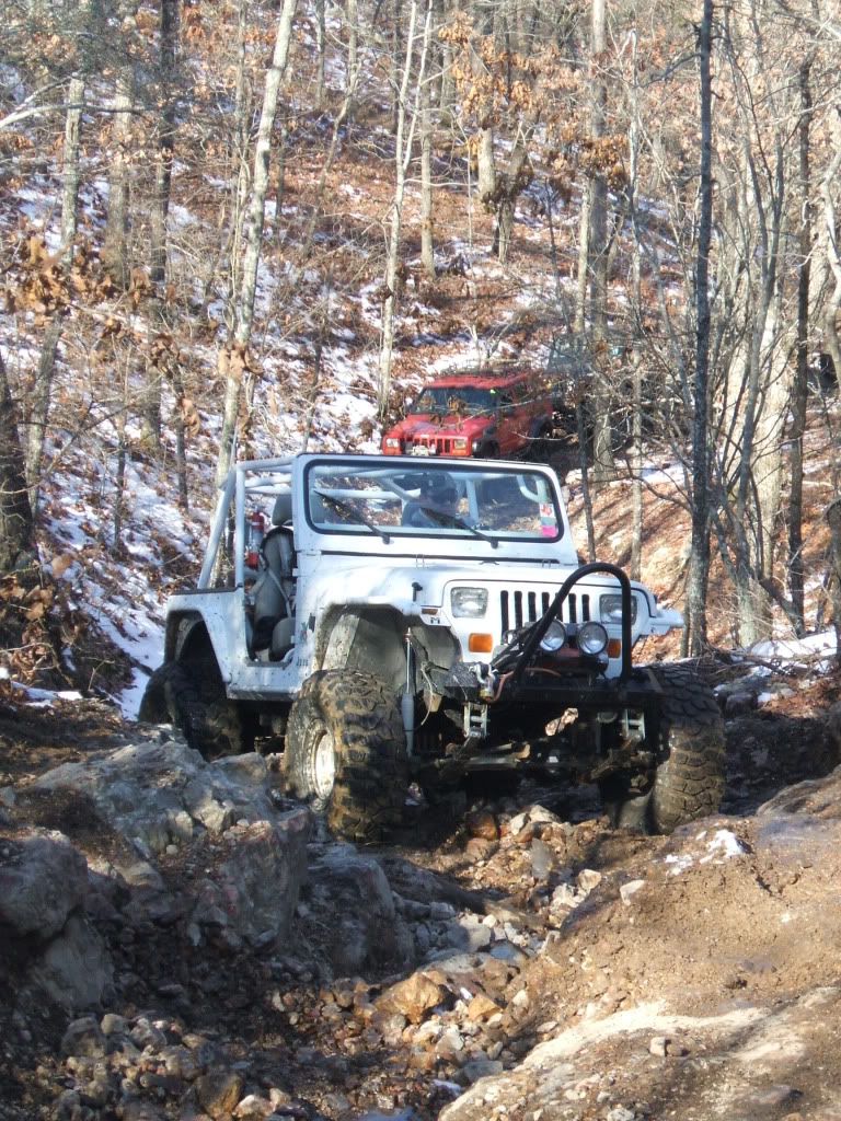

Thanks. I have stock bump stops up front and 3/8 greasable shackles. It flexes very, very well for a sprung under rig. The MC fenders made a huge difference. Before, with extended bump stops, my 33s would rub and tear up the flare and the metal lip of the fender. Now, I have smaller bumpstops and 35s and could easily fit 37s, (I won't, but they'd fit).

BTW, the pics I posted before have been changed, but instead of fixing those links, I am just going to give you a new pic to... um... review...
